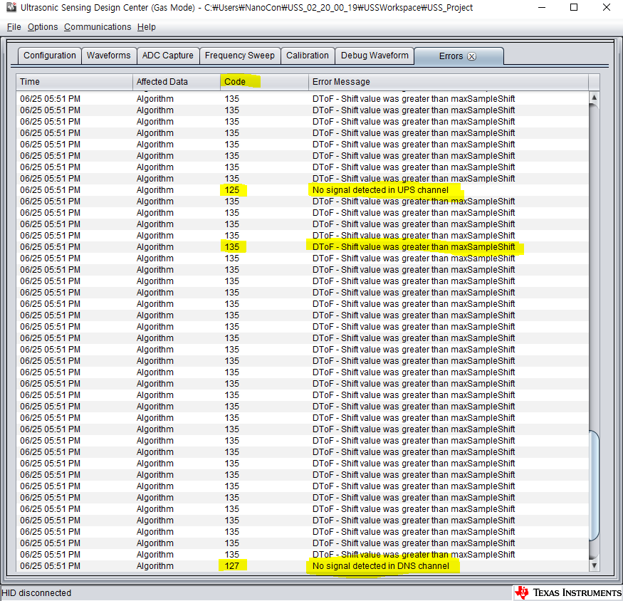

Let me know how to solve it.
What's the flow rate when you get these errors?
You can try to set this USS_ALG_MAX_SAMPLE_SHIFT larger in the USS_userConfig.h and see if it fix your issue.
