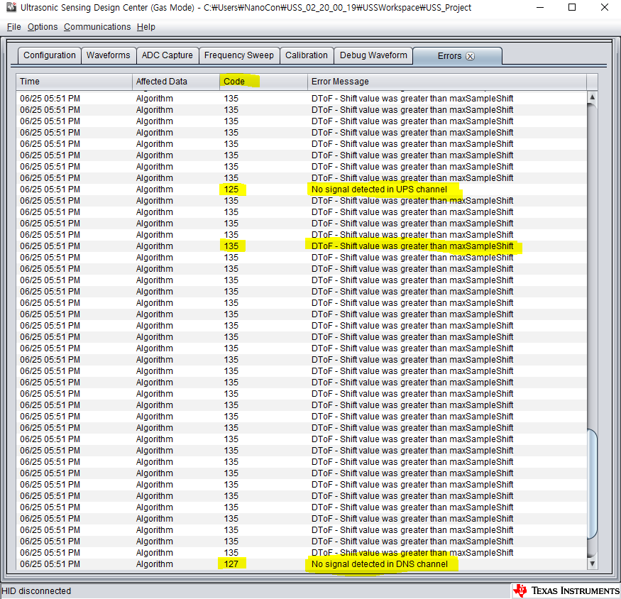

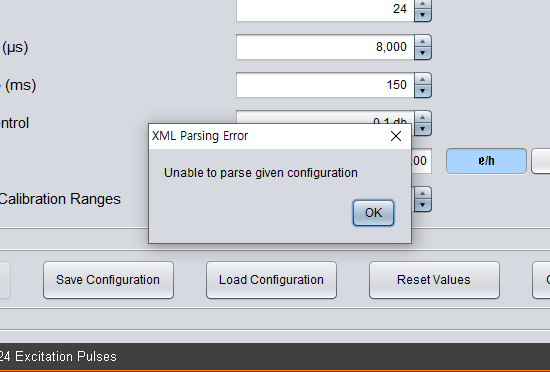

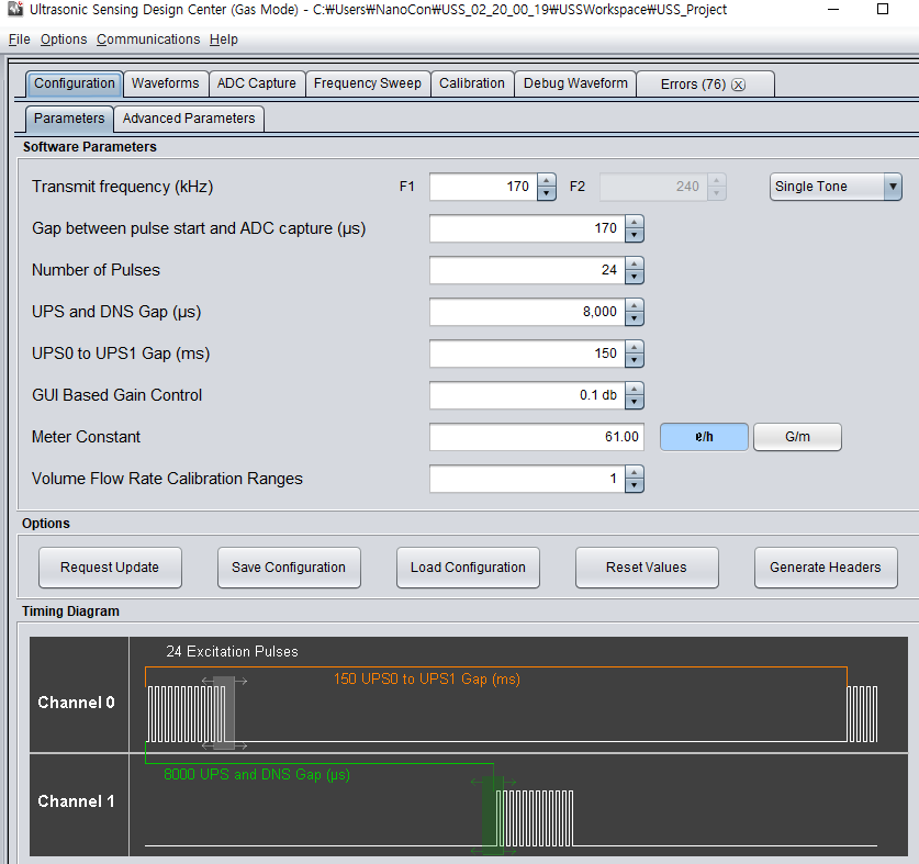

Part Number: EVM430-FR6043
I will ask you about the error.

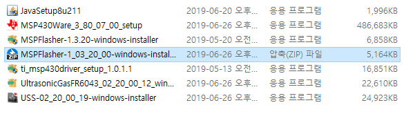

I downloaded 7 files as below.
But Error did not disappear.
We need a solution to solve this.
Have you try to set this USS_ALG_MAX_SAMPLE_SHIFT larger in the USS_userConfig.h and download the project without using "request update" function.
