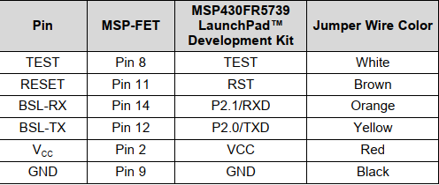

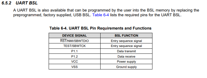

MSP430F5514: Connections for using UART-BSL using BSL Scripter Tool
Part Number: MSP430F5514
I want to use UART to interact with the BSL to update the firmware. The suggested pin-connection is this.
I am not using the launchpad. From what I understand the connection to the TEST and RESET pins is to invoke the BSL. I can, however, use the software option to invoke the BSL by using the line - ((void (*)())0x1000)();
In this case, can I just use a USB-UART converter(FTDI232)/FET with just the Rx, Tx and GND connections as in normal UART communication?
  • Hello Abhishek,
    I believe that should work.

  • Hi Dennis,
    I realised that the MCU has BSL transmit output and input pins which are separate from the UART Rx, Tx pins. Should I make connections to the BSL pins and not the on-board UART module?
    Thanks and Regards
    Abhishek
  • Hi Abhishek,
    Yes.  See the pinout table (below) for UART-BSL from the datasheet.
