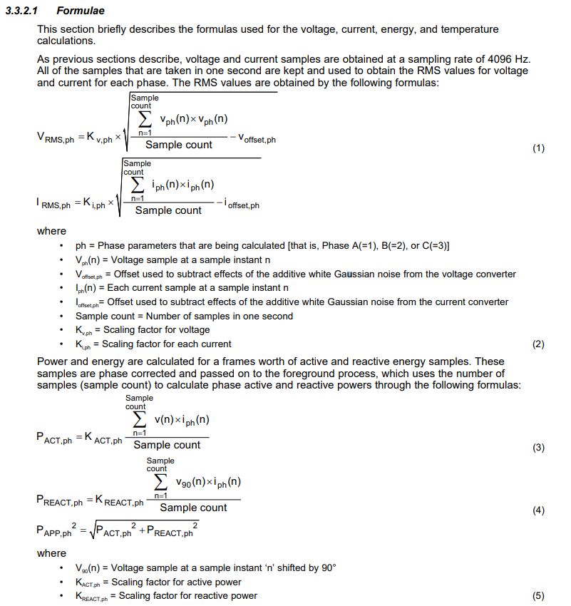

WHERE DO WE FIND DETAILS OF THE HARDWARE,SOFTWARE&CALIBRATION PROCEDURE FOR THREE PHASE TWO WIRE(TWO WATT METER METHOD).
VTC
In the TI reference design Class 0.5 Three-Phase Energy Measurement System with Enhanced ESD Protection Reference Design page, you can find the bom, pcb, schematic, software and design documents, etc.
Did you read the Class 0.5 Three-Phase Energy Measurement System Design Guide? In the design guide, there are e formulas used for the voltage, current, energy, and temperature calculations shown in below.
And these formulas are implemented in the software TIDM-3PH-ENERGY5-ESD Software.
For the calibration procedure, please refer to section 7.3.2 in above design guide.
Because the power is computed by above formula (4), not Vrms*Irms. You need calibrate the power.
The hardware also can be found in the reference design page.
