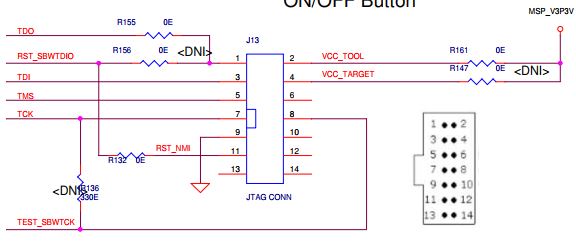

MSP430F5514: Communication through UART with a micro-controller having default USB BSL
Part Number: MSP430F5514
Other Parts Discussed in Thread: MSP430F5524, UNIFLASH
I was trying to communicate with the BSL through UART. The BSL wasn't responding with the right ACK. The MSP430 had come with a default USB BSL(the second file 5706.BSL 00.08.88.39.txt attached above). I figured that it might need replacing with an UART BSL. I chose the UART BSL from the MSP430F552x family(the first file attached above), combined it with the hex code of the application into a single .txt file and flashed it using UniFlash. I checked the contents of the locations 0x17FC-0x17FF - where the password resides - and it was 0xFF FF FF FF(it should be either that or all 0s). On flashing, there was an error message, something along the lines of incorrect number of bytes. It turns out that it ended up locking the JTAG access to my MCU. Unlocking it is only possible through the BSL which is what I was trying to accomplish in the first place, so I'm in a bit of a soup. I have a few questions.
(i) Is it possible to communicate to a device having USB BSL through UART? Is replacing the USB-BSL with the UART-BSL the right thing to do?
(ii) If so, where do I get the right UART-BSL file from? I can't find one for my device family. There is a folder having MSP430F552x_550x_Family. Could this be the right one? I don't want to lock the JTAG yet again. I still have to figure out how that happened. Any ideas on the same?
Please find attached the BSL files I used - BSL_00.08.88.39.txt (USB BSL) and BSL.00.08.08.04(UART BSL)

  • Hi Gary,
    I did the following things:
    (i) I tried filling the residual bytes and flashing the BSL using UniFlash. I got the following error - "MSP430: File Loader: Verification failed: Values at address 0x01000 do not match Please verify target memory and memory map." I thought I would reflash the existing USB BSL that had come with the device. On doing so, the MCU again got locked out of JTAG access. The BSL file is exactly 2048 bytes long and has FF FF FF FF at locations 0x17FC - 0x17FF. This is the second time I am accidentally locking the MCU. Could you please explain why this is happening? Please find the BSL I was trying to flash. My pin-out looks like the one in the attached image, with the RST_SBWTDIO also connected to 3.3V through a pull-up resistor. There has been no problem while programming the firmware through the JTAG interface.
    (ii)My second question has been resolved. The UART BSL doesn't use the on-board UART pins but different specialised pins.
    We are using a Vcc of 3.3V. I am using a standard MSP430 programmer like the one in the image. Pl
