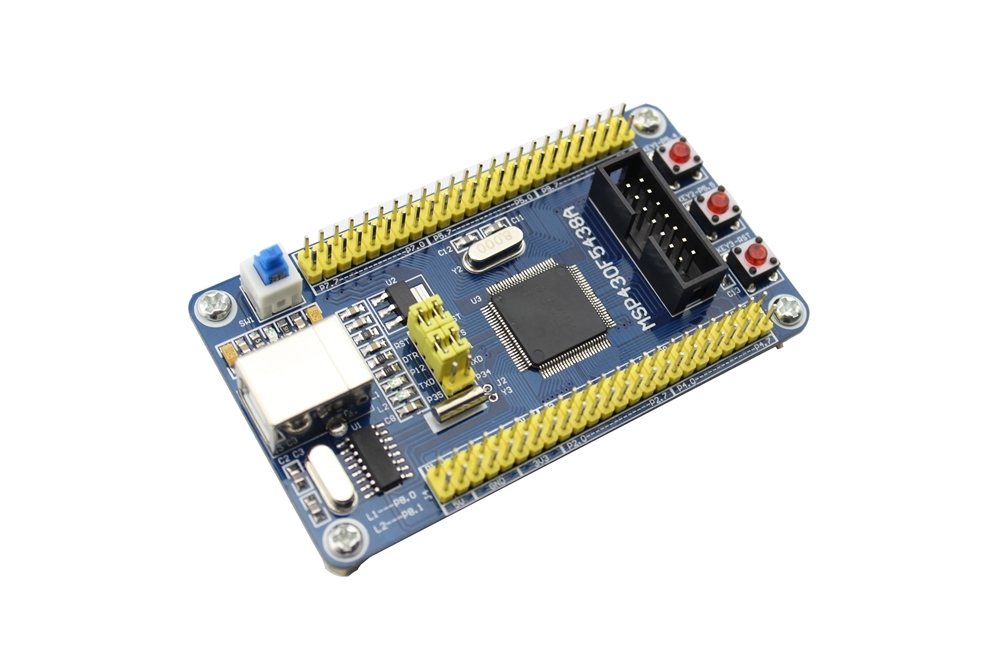

Hi All
I bought a msp430 development board (not from Ti) MSP430F5438A Development board from hotmcu, it is simple & low cost,

problem 1:
it include BSL Programming using USB convertor (chip CH340G) (work on Windows 10, device recognize (COM9) USB-SERIAL CH340)
and jumper was set
ch340 DTR -- msp430 RST
ch340 RTS --msp430 TEST
ch430 TxD -- msp430 DR P1.1
ch340 RxD -- msp430 DT P1.2
but could not find application to program it (use FlashPro 430 ver 5.6) but failed. (when start error box open "Programming Adapter has not been detected check  cable or latest USB Driver" can you help to solve this part.
problem 2
Use MSP-FET430UIF (the white old device) recognize by Windows 10 (COM17) MSP-FET430UIF - CDC
recognize by IAR Embedded Workbench IDE 7.12.1  but not with CCS v 8.0 (how to solve this)
when connect to developing board I think to remove the jumper and connect
ch430 TxD -- msp430 P3.5 RxD
ch340 RxD -- msp430 P3.4 TxD
and supply vcc from usb and jtag
can it work ?
