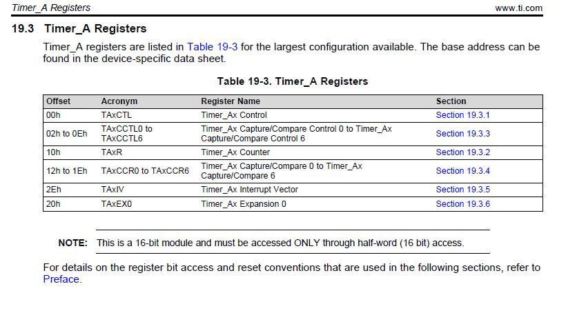

I'm trying to build a 3 channel synchronized PWM DAC with a cycle by cycle update capability, and I thought that I could take advantage of the fact that there are two TimerAx triggers. The plan was to use the CCR0 trigger to update CCR1 in a 16 bit transfer, and then use the CCR2 trigger to update CCR3 and CCR4 using a 32 bit transfer.
However, when I try to do this on the MSP432, it appears that the CCR2 DMA trigger is simply not being triggered.
Here are some test scenarios I tried:
DMA CH0 CCR0 EN CH0 SRC INC CH0 DEST CH1CCR2 EN CH1 SRC INC CH1 DEST Result
Y 16 TA0CCR1 Y 32 TA0CCR3 DMA updates to CCR1, no DMA updates to CCR3/4
N N/A N/A Y 32 TA0CCR3 No DMA updates to CCR1, CCR3, or CCR4
N N/A N/A Y 16 TA0CCR3 DMA updates to CCR3
N N/A N/A Y 16 TA0CCR4 DMA updates to CCR4
Y 16 TA0CCR1 Y 16 TA0CCR3 DMA updates to CCR1, CCR3. No updates on CCR4
I had DMA CH1 assigned to a seperate DMA_ISR handler, and as expected this never gets called because the transfer never completes.
Any thoughts on why a 32 bit transfer here is invalid? The timer CCRx memory space is contiguous so in theory it should work. Does the timer A peripheral truncate all writes to 16 bits?
Looking forward to some ideas.
