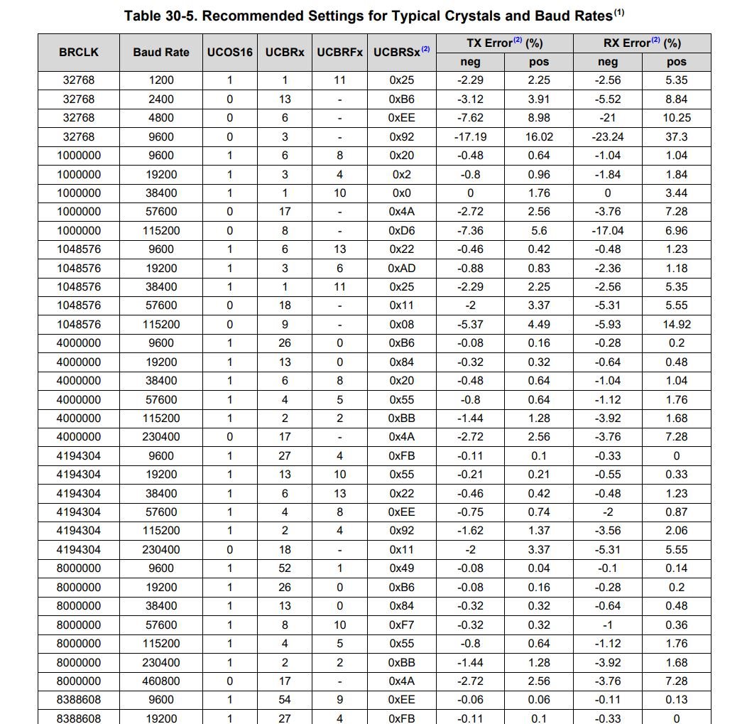

    What's the frequency of BRCLK? And your Baud Rate? Please use the recommended settings in below table in User's Guide.
  • Hi Winter,
    this settings i used.
    My MCLK = 16MHz
    SMCLK = 8MHz
    ACLK = 10KHz
    Baud Rate = 9600
    so i think so this settings are correct.
    Anil.

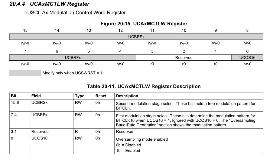

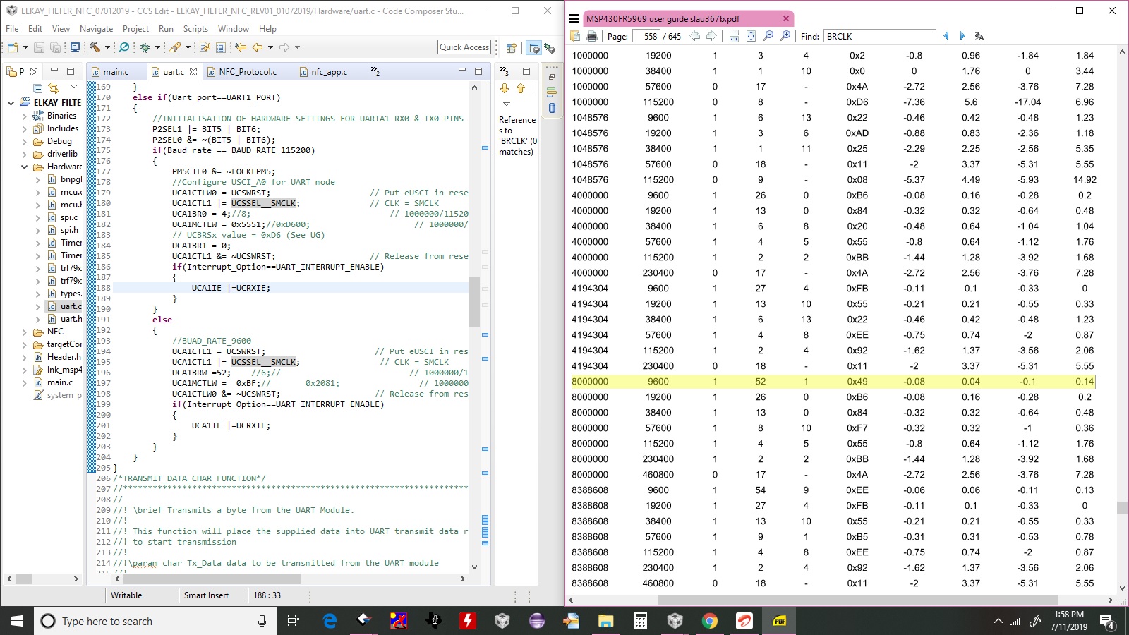

    But in configuration above i am seeing one error value i kept.
    can yo u look that. -  UCA1MCTLW =  0x4911;  //0xBF;   here we need to configure the 0x4911 instead of 0xBF, am i right?
    because 8000000/9600 = 833.333... so for 0.33 there is a 0x49 value is there, see in the image itself.
    and later that 0x4911 came, so that 11 is for
     so i will keep there 0x4911, is that all configuration correct? or other things also i need to check here or initialize?
    Can you please check from your side?
