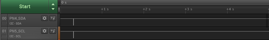

However, I observed that even when the program is halted at a specific break point and I try capturing the data on pins I2CMSP432E4_PN5_I2C2SCL and I2CMSP432E4_PN4_I2C2SDA.
It displays some data on the both the pins.
As per my understanding there should not be any data when its program is halted it could be at max either continue to be HIGH or LOW
Problem-1:
Should there be some data when debugger is halted?
Problem-2:
As I see the example code it calls the I2C_Transfer function for address and returns FALSE to enter in to while loop for ever. It seems to be the error where it is not able to resolve the sensor.
Any clue? why does it return false? Am I missing any config?

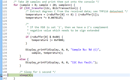

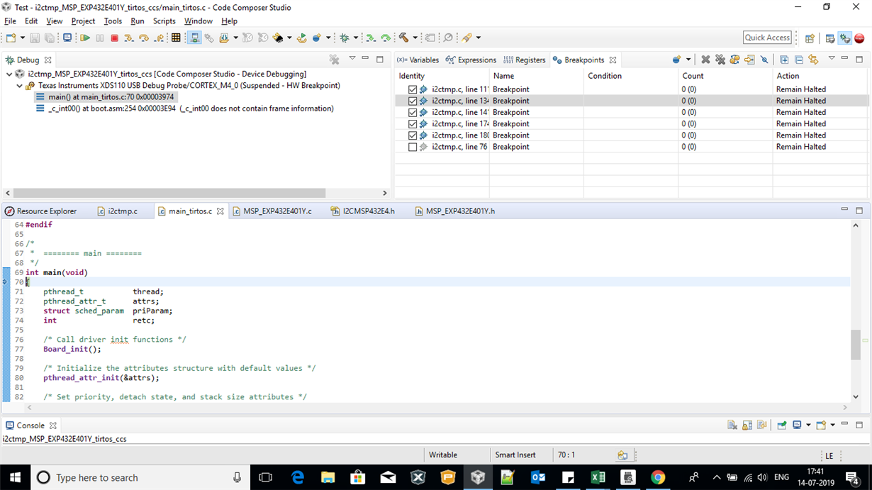

    I ran the example ../example/rtos/MSP_EXP432E401Y/drivers/i2ctmp116 and the example ran as described in the Readme. I used the BOOSTXL_BASSENSORS boosterpack to talk to TMP116 sensor.
    If I place a breakpoint inside the "for" loop then the I2C bus halts, as expected after one transcation. See screenshots of the code with breakpoint set and the associated screenshot of the I2C bus.
