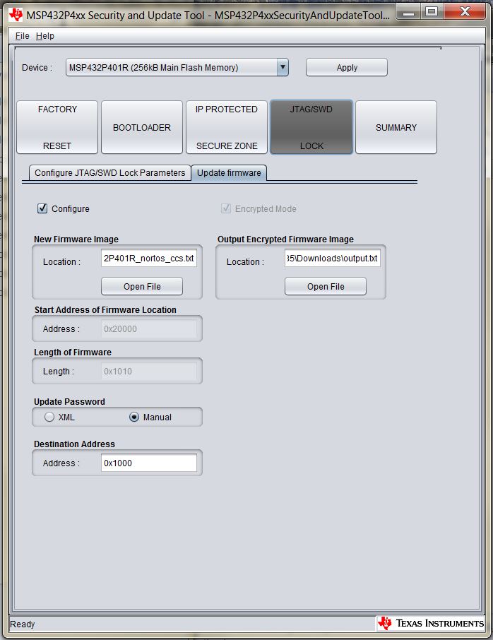

to use the update firmware image via JTAG/SWD lock mode some specs need to be meet:
- the new image needs to be placed in Bank 1 of Flash (address of Bank 1 starts from size memory / 2; if you are using P401R, that means Bank 1 starts at 0x20000)
- i expect that when you try, you got the pop up message like first screen shot:
- i changed the address from your images from @0 to @20000 and the result shown at the second screen shot below:
Hi Fatmawati,
If you download the file I originally attached pwmled2_MSP_EXP432P401R_nortos_ccs.txt and click Open File within the New Firmware Image box, I receive the same pop up as you have shown. However, after I click OK, the program freezes.
I cannot modify the start address of firmware location since the program is frozen and the start address of firmware location box is greyed out.
We are using the newest version of the tool found online: v.1.01.00.00

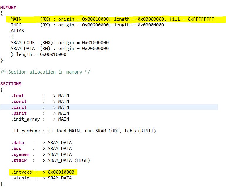

I apologize for the late reply. I found the limitation in the tool that it did not read the image which are chucked.
What I can offer as workaround, if you work with ccs, under linker command file in the project, we can add the "fill" to fill the gap between two chunks. However the "fill" with fill the memory completely, that means it is generate the image size equal to the main memory size. therefore we need to adjust main memory section relates to the size of actual application.
in this example below that i tested, i am using MSP432P401M, which flash bank 1 starts from 0x1:0000. since the image generated is about ~0x2000 bytes, i put the size of main 0x3000. i also need to move the .intvect to the new location of 0x1:0000.
let me know if this workaround helps you.
