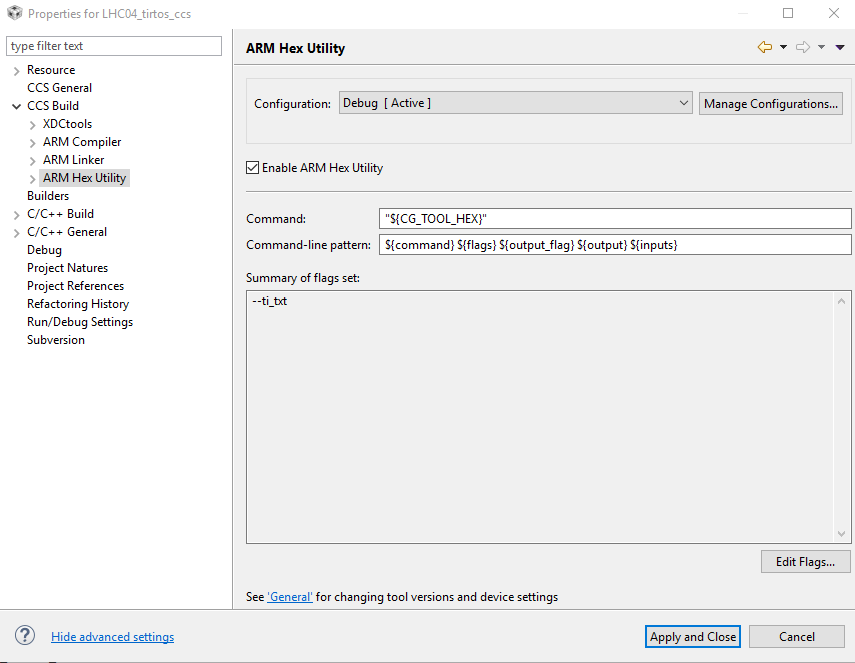

    the files are not the same, because LM flash programmer needs *.bin while BSL scripter needs *.txt.
    I generated the files at the same build using
    for .bin post build step:
    "${CCE_INSTALL_ROOT}/utils/tiobj2bin/tiobj2bin.bat" "${BuildArtifactFileName}" "${BuildArtifactFileBaseName}.bin" "${CG_TOOL_ROOT}/bin/ofd470.exe" "${CG_TOOL_ROOT}/bin/hex470.exe" "${CCE_INSTALL_ROOT}/utils/tiobj2bin/mkhex4bin.exe"
    and for .txt the following settings:
    Could you send me an email address to send the files to? (I don't want to post those.)
