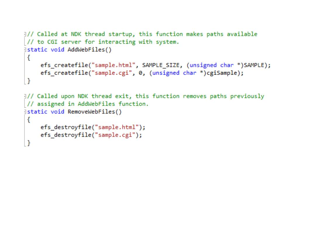

Below figures shows how i added the web pages:

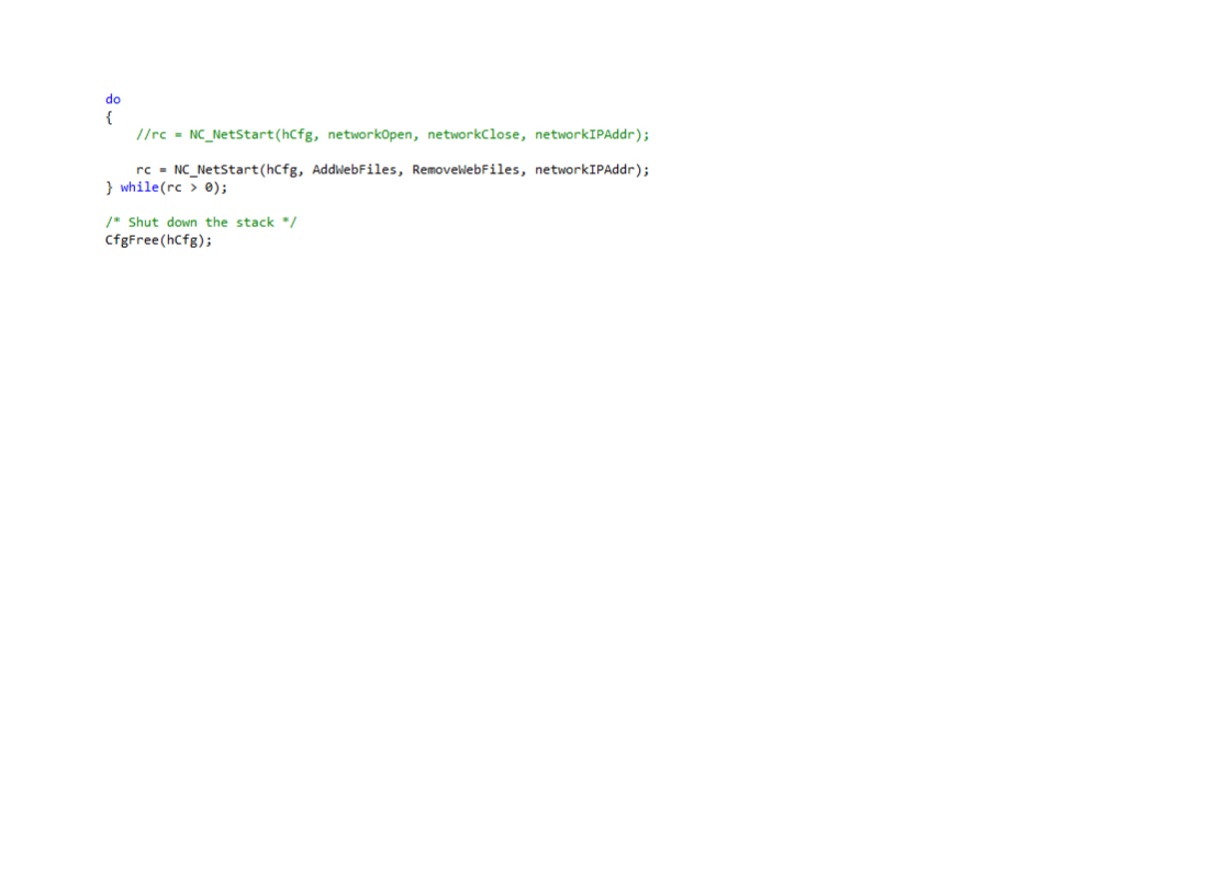

In the "ndkStackThread" function i have added these web files instead of Network open & Close as shown below.
I have changed my RAW_PAGE_COUNT to 20 as well.
Can any one tell me where i missed out to execute properly.

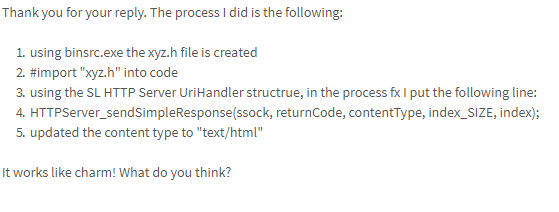

    2. In the post you have suggested, there is comments like
    So as mentioned above i have added .h file and .html file to the project and the below line in the "URLSimple_process."
    HTTPServer_sendSimpleResponse(ssock, returnCode, contentType,INDEX_SIZE, INDEX);
    and replaced "if (strcmp(url, "/home.html") == 0)" with the "if (strcmp(url, "/index.html") == 0)"

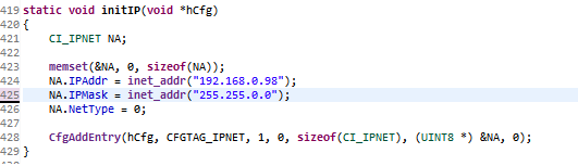

    And i have replaced InitIP with
    but it didn't worked.

  • Hello sai,
    I started with that static ip addressing  in tcp echo example and it did worked well.
    After that i try to add some web pages to the particular ip address as posted earlier.

  • Hello Kalyan,
    So it looks like the HTTP Webpages are not being served by the MSP432E4.
    Can you put a breakpoint in the application and see if the execution is reaching at the expected section of code when the IP address is entered in the browser?
    Also it will be helpful to capture a wireshark log of the what the browser is transmitting and check if your application is handling the request.
