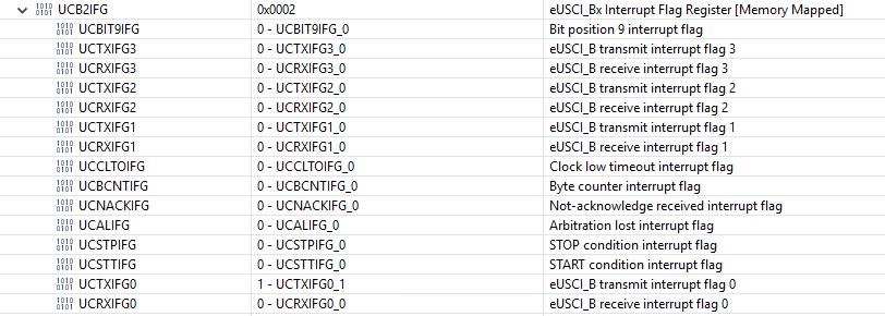

    I appreciate your response. The problem is as long as my debugger is attached, my all peripherals works properly along with my I2C communication with a slave. The problem arises when I detach my debugger and then power on my device. Everything seems to hang. I somehow found out that my control remains on __bis_SR_register(LPM0_bits + GIE) hanging. I unterstand your approach to come out of LPM by LPM0_EXIT. My Question is what if I2C never works. I always have to jump out of LPM through my timmer. Is there no other way to trigger I2C interrupt execpt going to LPM.
    Thank you alot.
  • The short answer is that you don't need to be in LPM for interrupts to happen. If (as you mentioned) you set GIE up at the top of your program, they can happen any time during the execution of your other code. (Strictly speaking, you don't even need the "+GIE" part, but it's not a bad habit to get into.)
    In fact, based on your description, I'm wondering if you're encountering a race in which your I2C operation completes before you go into LPM, and as a result there's no stimulus left (since the wakeup happened a "long time" ago) to wake your main() program up. (The debugger typically affects your program's timing.)
    What you should probably add is a global flag e.g. "I2C_Done", which is set by the ISR as part of wakeup and checked by main() before (and after) going into LPM. This is a good idea in any case if you have multiple wakeup sources.

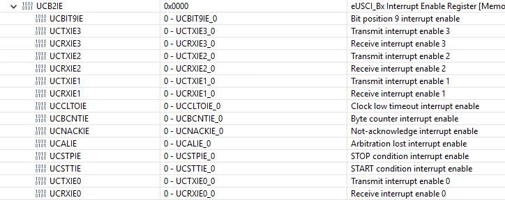

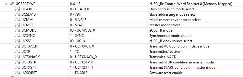

  • Hi Bruce, I appreciate your apt Response. I have tried the Suggestion you have stated in your message to come out of LPM0_Exit after a time interval. The Problem is as I feard earlier. I am able to bring back device in life that means all other peripherals works properly, however my I2C communication don't really work at all. I am unable to receive data from my slave, which in fact works perfectly as Long as Debugger is attached. Do you have any clue, where I am lagging or what is going wrong?
    What do you mean by your sentence  "I'm wondering if you're encountering a race in which your I2C operation completes before you go into LPM."
    Would it help me if I sets the flag as you mentioned "I2C_Done"?
    If yes what would be the correct way to do it. In my ISR, would I set a flag as "I2C_Done = 1" and in my maine function back to "I2c_Done=0"?
    I have attatched my Registers configurations, if that could tell anything.
    Thanks a lot.

  • What I see here is that UCSWRST is still set. Based on a single snapshot, this could be cause (issuing an STT while the I2C is in reset) or effect (the STT got "stuck" and UCSWRST was set due to timeout). Stating the obvious: Once a timeout has set UCSWRST, someone needs to clear it before the next operation.
    Re-reading your code, "(MasterModeI2C==IDLE_MODE)" is probably a suitable substitute for my suggested "I2C_Done" flag. Are you checking the ReadReg() return value?
    Are "I2C done" and "I2C Timeout" the only wakeup sources, or are there other cases (not shown) where e.g. the timer ISR might do a wakeup?

    I appreciate your Response. UCSWRST is enabled, because I was Setting it again and again every 10ms in my Timer Routine along with LPM0_exit. If I comment it in my Timer Routine. The UCSWRST value in Register section Shows to 0.
    I have debugged it in steps and find out MasterModeI2C = TX_REG_ADDRESS_MODE, which it has to be once I call ReadReg(). However once I step Forward into ReadReg() to jump into my ISR, it remains stranded on  __bis_SR_register(LPM0_bits + GIE). I have added break points in my ISR everywhere. It ain't coming not even a single time in my ISR. That's the reason it gets stuck there and Nothing works.
    I'll appreciate your Response.
