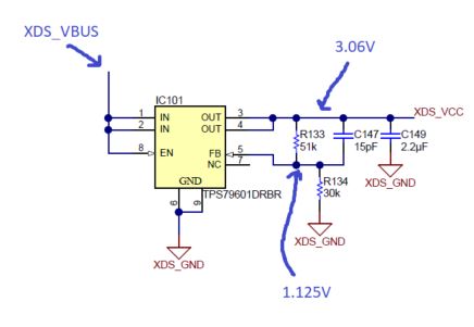

I am using a SimpleLink™ Ethernet MSP432E401Y MCU Launchpad™ Development Kit with a developed BoosterPack that utilizes both the 3.3V and 5V rails from header J1/J3. The main issue is that after using the Launchpad for a while the TPS79601DRBR LDO has somehow been damaged and instead of 3.3V I am seeing around 3.06V. This has happened with two Launchpads, do you know of any reasons this might be happening or if this has been an issue in the past?

I used two power supplies and no launchpad to power my BoosterPack and the current drawn from the 5V is around 56mA and the 3V3 is around 1mA. Before the LDO voltage dropped to 3V instead of 3.3V I believe my scope showed that the voltage on that pin went all the way up to around 5V.

Jadyn,
Can you confirm that the XDS110 is damaged by removing the connections and confirming that the 3.3V rail is still at 3.0V even with no MSP432E and no boosterpack?
