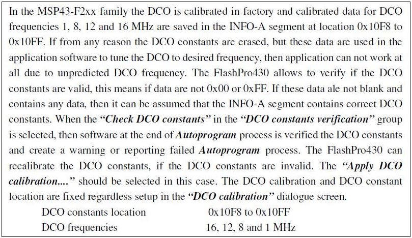

    According to the document FlashPro430 USB-MSP430 Flash Programmer User’s manual under DCO constant verification section, it mentions that the address from 0X10F8 to 0X10FF should contain DCO data but not 00 or FF. Else, the application cannot work due to unpredicted DCO frequency.

    Since these DCO calibration data can be modify or erase by user code or programmer tool, this problem mostly is a application issue.
    You should check your code and programming sequence firstly.
    A recommend solution is to re-calibrate the DCO by yourself.
    And see if these data will be 0xFF again without any write or erase operation by user.
    If still 0xFF, then it may be a IC failure, you can send the part to TI for FA.

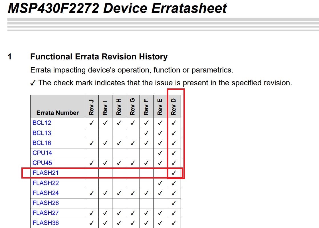

    Besides, what's the failure rate and device revision?

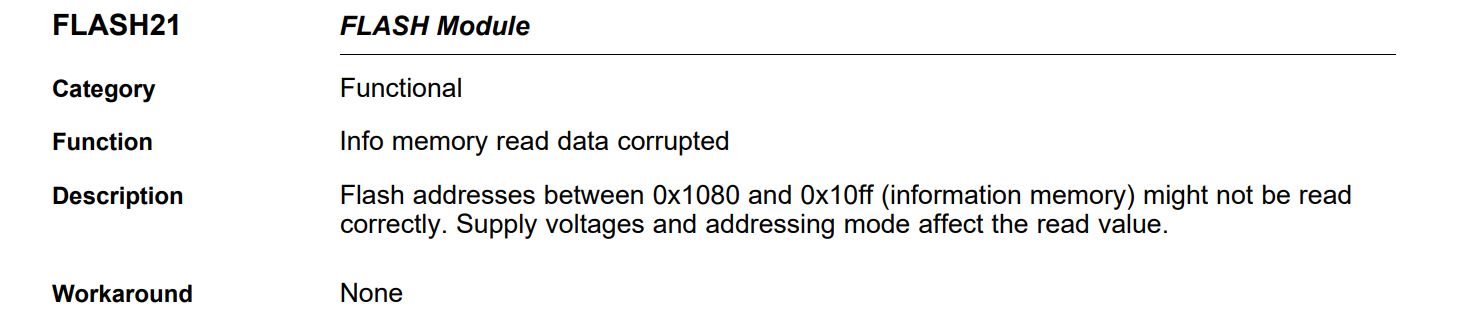

    I checked the MSP430F2272 Device Erratasheet (Rev. M). There is a bug about your issue. The FLASH21 bug is only present in revision D.

    As mentioned by you that there is a bug about the issue. The FLASH21 bug is only present in revision D.
    So can I send the IC to TI for Failure Analysis in this case?
    Br,
    Teach Me
    What's your revision? Not revision D? If so, you can apply for FA.

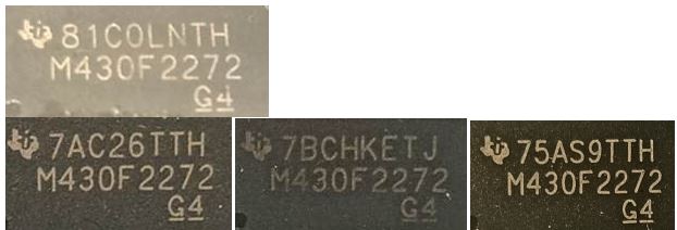

  • Hi Winter Yu,
    May I know how to verify that the MCU at my side is a revision D or not?
    Is it from the body marking?

  • Yes, the body marking.
  • Hi Winter,
    Is the below body markings fall under revision D?
    Please advice,
    Teach Me
  • Please see the MSP430F2272 Device Erratasheet (Rev. M). The revision is H and J in above marking.
