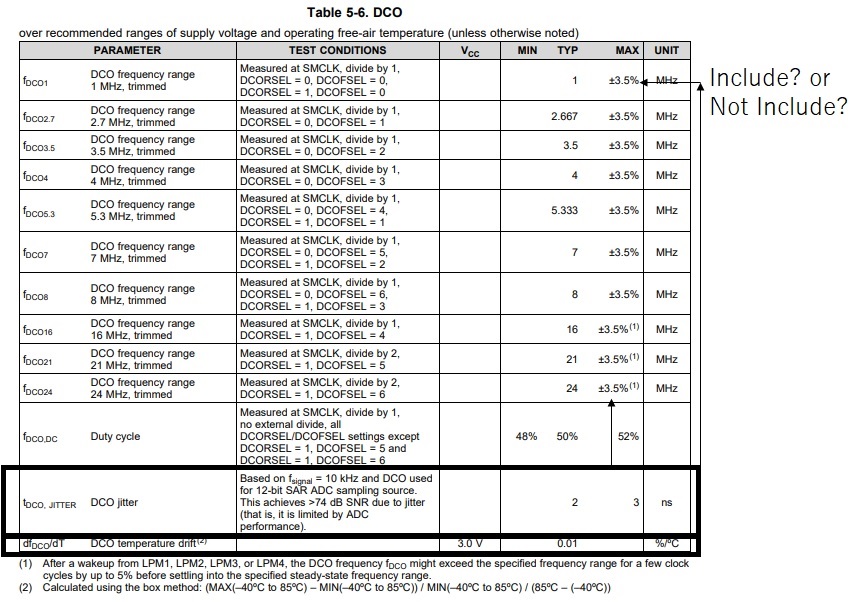

My customer asks me about the DCO accuracy of MSP430FR5xx, 6xx.
Please confirm.
The datasheet describes the frequency and its accuracy (± 3.5%) for DCORSEL and DCOFSEL values.
In addition, it's also discribed "DCO jitter" and "DCO temperature drift".
<Question>
Does the accuracy of ± 3.5% include these drifts?
