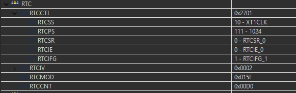

Here is the issue, the above code was just my test for implementing the dual timer, enable disable process. I've moved over the code to my actual program and what I'm seeing is after I exit the low power mode the first time, which works correct, my system re-enables timer_b0 and counts just fine, but when its time to enter lowpowermode, it jumps immediately to the ISR. No delay.
I checked the registers, and RTCMOD is still showing 15F (351 or 11 seconds). There is no difference between the registers before and after the first time it enters lpm.

  • As long as RTCSS is non-zero the RTC will continue to count. As it happens, your RTC cycle is the same as your TB0-ten-times cycle, so RTCIFG (as seen in your register dump) is already set when you set RTCIE.
    TB0 is also still counting (since you haven't set MC=0) all the time, but the effect of that is probably less visible.

    >>As long as RTCSS is non-zero the RTC will continue to count. As it happens, your RTC cycle is the same as your TB0-ten-times cycle, so RTCIFG (as seen >>in your register dump) is already set when you set RTCIE.
    Ok, so if I'm understanding correctly.
    even though I am doing
    RTCCTL |= RTCSR | RTCIE;
    I am obviously enabling the interrupt, but more importantly I thought that RTCSR was resetting the counter. per the documentation
    RTCCNT is cleared by the overflow event, or it can be reset by software writing logic 1 to the RTCSR bit
    in the RTCCTL register.

  • But RTCSR doesn't clear RTCIFG, which is what I expect you are (were) encountering.
    Also, the RTCCNT clear operation takes one XT1CLK cycle (~30us) which is probably long enough to create an illusion in your register dump.
    Anyway, I'm glad you got it working.
