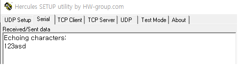

But, in Step-2 uartecho.c halted when I hit ‘X’. When I debug these programs with CCS, I find uartecho.c stopped at the point of mq_send() api call.
Following screen shot shows program halted when ‘X’ is pressed.
Following shows debugging screen that I got when hit “Suspend” debugging button when uartecho.c halted.
Could you kindly advise me what is the real problem in here ?
