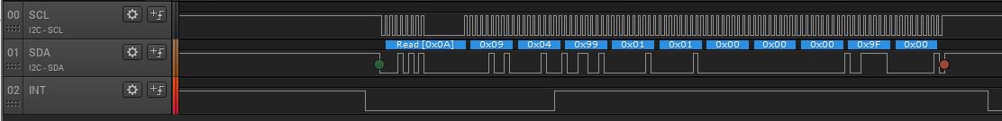

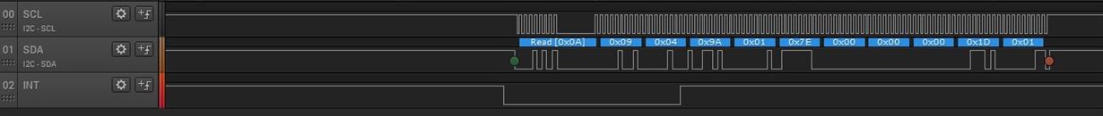

    I took some I2C logic analyzer captures with the EVM connected to the GUI.  I do receive the correct response to the 0x99 command.  If I do not have a pipe connected to the EVM, I am also seeing the error packet as you have seen.  The response to the 0x99 command is only sent after the measurement is made, so this may take 1sec if that is the measurement interval you have set.  See the captures below.  I think the problem is that you are seeing the error packet before you are receiving the response to 0x99 and your packet handler is not taking care of the response to the 0x99 request.
  • Thank you very much for your response.
    I have done the same analysis and come to the same conclusion.
    But I can see in your pictures that you have an interrupt line attached (comm_irq I suppose). is that correctly understood that I only can read answers when interrupt line goes low?
    I will try to see if I can get some more useful answers if I implement it with interrupts.
  • Correct, the interrupt line can be used to indicate when new data is available.
  • perfect, thank you.
