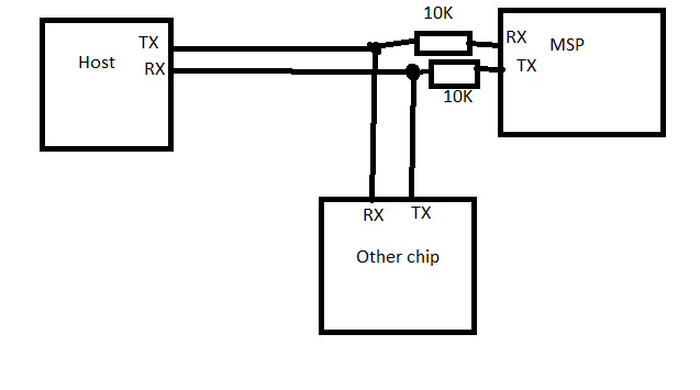

Note: We are using the same uart bus for another component. The oscilloscope screenshots below are all taken on msp side, and I've disconnected MSP TX to avoid side effect from the other chip.

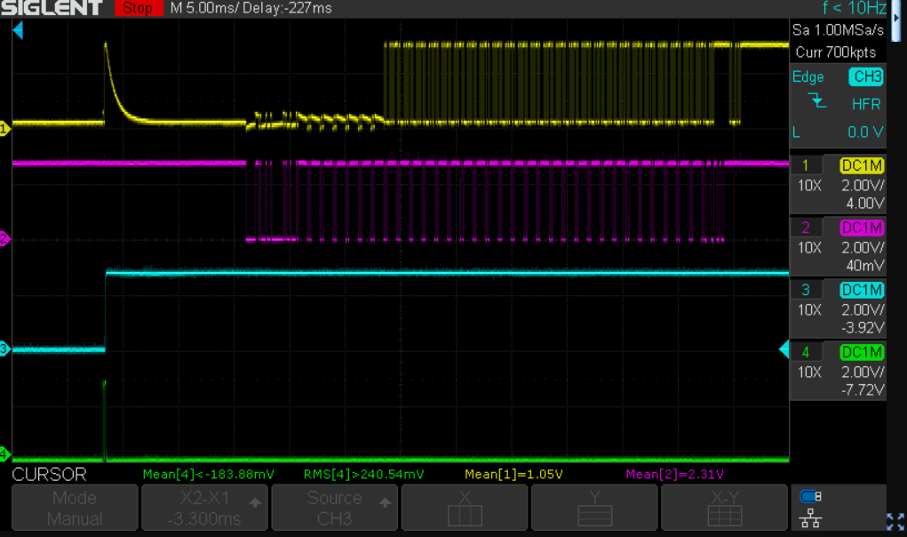

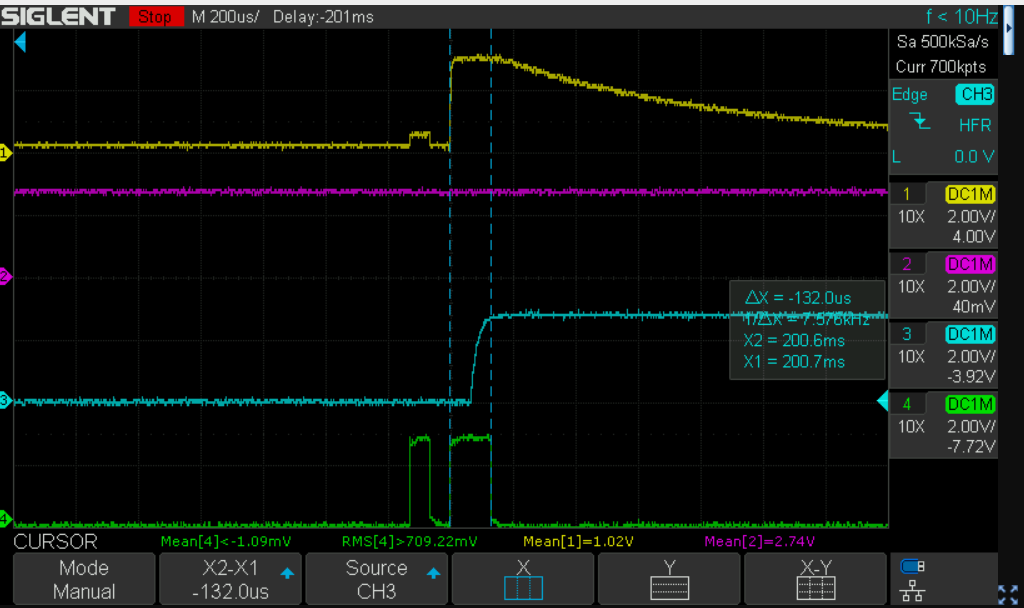

Here is the screenshot of the touch reset sequence:
Green: TEST
Blue: RESET
Pink: BSL_RX
Yellow: BSL_TX

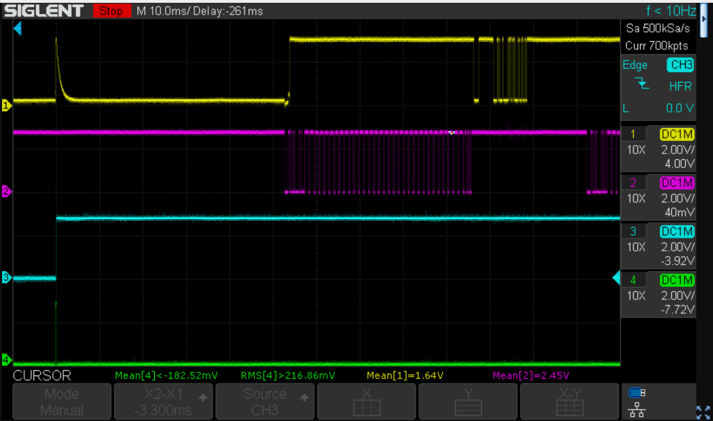

Here is the screenshot of the TX BSL Version command:
