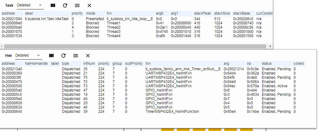

I have an applications in which i have written multi thread code for sending & receiving the data over different uartS along with the i/o's.
And i am using a timer for sending the data out for every 50ms on uart.
This code is executing well up to a certain time after that it is hanging.No Thread is executing.
When i remove the code in timer callback functions and then everything is executing properly.
In that callback function  i am sending the data over one of the uart and i am not using that particular uart in any other threads. But still it is hanging after certain time.
What might be the cause for this.

  • Hello Kalyan,
    Did you confirm if the stack overflow of the task are not occurring? You can use ROV tool to check if the stack of each task is not overflowing. You might also get an exception on stack overflow.
    Sai

  • Hello sai,
    These are the results i got after running the ROV:
    After Operating the IO controls:
    Here It seems i haven't had any stack overflow.
    Then What might be the issue sir.

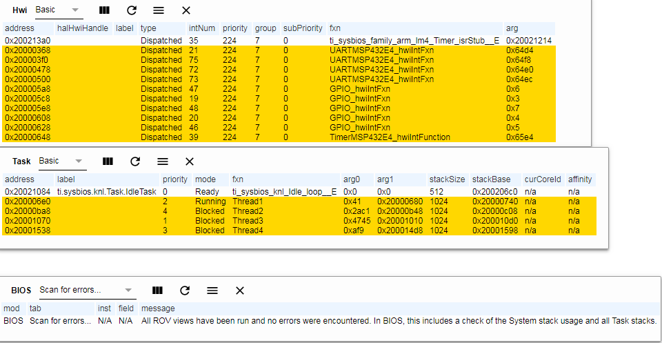

  • Hello Sir,
    I am getting the exception after running the application.
    These are the result after checking the "Scan for Errors" in BIOS :
    The detailed text is:
    ti.sysbios.family.arm.m3.Hwi Module N/A exception An exception has occurred!
    ti.sysbios.knl.Semaphore Basic (0x20000520) pendElems Error: Problem scanning pend Queue: JavaException: java.lang.Exception: Target memory read failed at address: 0xffffffff, length: 8 This read is at an INVALID address according to the application's section map. The application is likely either uninitialized or corrupt.
    ti.sysbios.knl.Task Detailed ti.sysbios.knl.Task.IdleTask blockedOn Invalid task internal state: pend element address (0x0) is not within the task's stack
    Please guide me to get rid of this exception.

    Please suggest some solution for this exception.
    I have used uart_write function in timercallback fxn. Is that causing exception. Or is that OK.
    Kalyan.
  • Hello sir,
    Some more information :
    I have used timecallback function as:
    void Timerfxn()
    Gpiotoggle(GPIO_BOARD_LED0);
    UART_write(uart,&Tx_data,8);           // In Blocking mode
    If i use gpiotoggle only in the call back fxn then it is working fine and if i use uart_write fxn then after some time, i am getting exception as mentioned in one of the above post.
    I am not getting this exception is what for.
    Please reply.
    Kalyan.

  • Hi Kalyan,
    Have you tried using the UART_write() in callback mode instead of blocking mode?
    Alexis
  • Hello Alexis,
    Thank you so much for the response.
    No i haven't tried.Since i am not using the particular uart which i have used in timercallback fxn in any other threads, so i thought it is ok to use in blocking mode.
    Am i wrong?
    And one more thing is that, do you think the timer event i am calling for every 50 milli seconds was blocked by this uart_write in  UART_MODE_BLOCKING mode?
    Kalyan.
  • Hi Kalyan,
    Sorry I clicked TI thinks resolved by mistake. Yes I'm guessing that this is what is happening. UART blocking mode will block task execution. Please try callback mode instead as it is safe to call from SWI or HWI.
    Alexis
  • Hello Alexis,
    That uart write callback implementation I will try tomorrow and then I will post the feedback.
    And one more doubt I have,
    By simply initialising uart like
    Uartparams. Writemode =UART_MODE_CALLBACK,
    Uartparams. Writecallback=NULL,
    and then in timer callback can I call the uart_write function. Like
    void Timerfxn()
    Is it the right way to use uart_write in callback.
    Kalyan
  • Hello Alexis,
    Can I write the uart_write in callback mode as mentioned in the above post.
    If not, please help me in writing the uart_write in callback mode along with the timer.
    Kalyan.
  • Hi Kalyan,
    For information on how to implement UART in callback mode,  please refer to the documentation: http://dev.ti.com/tirex/explore/node?node=ANw0S9TRUnZu6GuxbMlzjA__J4.hfJy__LATEST
    Alexis
  • Hello Alexis,
    Thank you. After changing the uart_write to callback mode, it is working fine.
    Kalyan.
