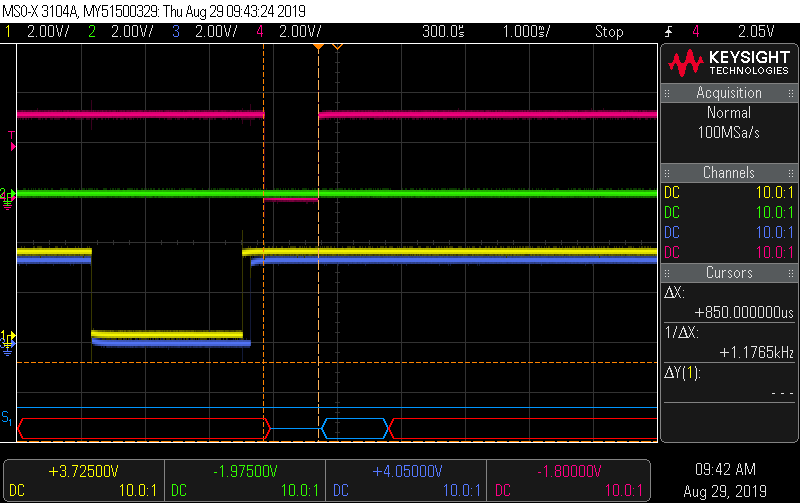

Currently, my client is having a problem with MSP432P401R configuring BSL interface issue.
The following is the BSL config in the flash mailbox:
    /* BSL Starting address, default pointing to TI BSL at 0x00202000 */
    BSL_API_TABLE_ADDR,
   /* BSL Parameter
     * Use HW Invoke on Port 1, Pin 1, on HIGH
     * Use UART
    BSL_CONFIG_HW_INVOKE_PORT1 | BSL_CONFIG_HW_INVOKE_PIN5 |
    BSL_CONFIG_HW_INVOKE | BSL_CONFIG_HW_INVOKE_PIN_HIGH |
    BSL_CONFIG_INTERFACE_UART,
And I'm controlling the reset and P1.5 with my beagle bone black and getting the following traces on the system
Chan 1 / Yellow = P1.5
Chan 2 / Green = TX
Chan 3 / Blue = Reset
Chan 4 / Red = RX
The following images are the same sequence but at different time scales.
The dip on the TX is the sync byte (0x80) but there is not the expected response to it.
Any advice?

  • Hello Sebestian,
    According to the MSP432P4xx BSL User's Guide, section 3.3.2 Hardware BSL Invocation, it looks like the pin used to invoke BSL should be asserted for a few cycles after Reset is asserted. It's not clear how many cycles though...
    From the above image, the second arrow is when BSL gets executed, the first arrow is when the Bootcode gets executed. Can you increase the duration for which P1.5 is high to ensure that the BSL is actually invoked?
    According to the MSP432P4xx BSL User's Guide2.2 UART Protocol Definition, the Sync word is 0xFF. Is there a reason you are using 0x80?
