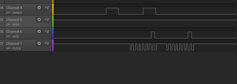

i m trying to integrate msp430f5438a & winbond spi flash ic via spi communication. i m facing problems in transmitting data from master(msp430f5438a) to slave select. i think i m doing mistake in slave selection enable & disable. if i m seeing the signals in logic analyser slave select pin is not syncing with mosi & clock signal. if i disable "Enable" option in logic analyser settings, given data signals are perfectly shown on analyser.
i have attached my code, please help me where i m doing mistake. also i have attached my logic analyser o/p.

  • > while (!(UCA0IFG&UCTXIFG));
    This doesn't wait for the byte to be transmitted, so the chip select happens too early. (It's also the wrong USCI.) Try instead:
    > while (!(UCB0IFG & UCRXIFG)) /*EMPTY*/;  // Wait for byte exchange to complete
    > (void)UCB0RXBUF;  // Clear UCRXIFG for next time
    and remove this line, since the IE will just get in the way:
    > UCB0IE |= UCRXIE; // Enable USCI_A0 RX interrupt

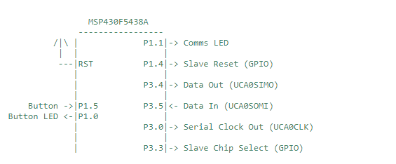

  • I have  doubt on your statement. if i remove UCRXIE, then how can i receive the data from slave? i m getting confusion with this. please clarify it.
    i checked 4 wire spi in ti explorer. it gives me some idea. but in 4 wire communication we need only 4 wires right(Clock, miso, mosi, slave select). but they have configured 5 wires for mater , slave communication. please clarify this.
    Here, what is slave reset is used for ? and what is slave select is used for ?
    In my spi flash ic, there are clock,DO,DI,CS,VCC,GND, WP pins only available.

  • > In my spi flash ic, there are clock,DO,DI,CS,VCC,GND, WP pins only available
    The SPI people came up with a perfectly good, unambiguous nomenclature for these pins, but some manufacturers somehow forgot it:
    SCK: CLK (Serial ClocK)
    MISO: DO (Master In Slave Out)
    MOSI: DI (Master Out Slave In)
    /CS: /CS (Chip Select)
    Your Flash chip doesn't have a slave reset, so don't use that.
    What it does have is /WP and /HOLD, which you need to deal with: There's no mention of internal pullups on these pins (presumably due to the QSPI feature), but they mustn't be allowed to float. If your board doesn't connect these to Vcc, you should connect them to GPIOs and drive them high.
