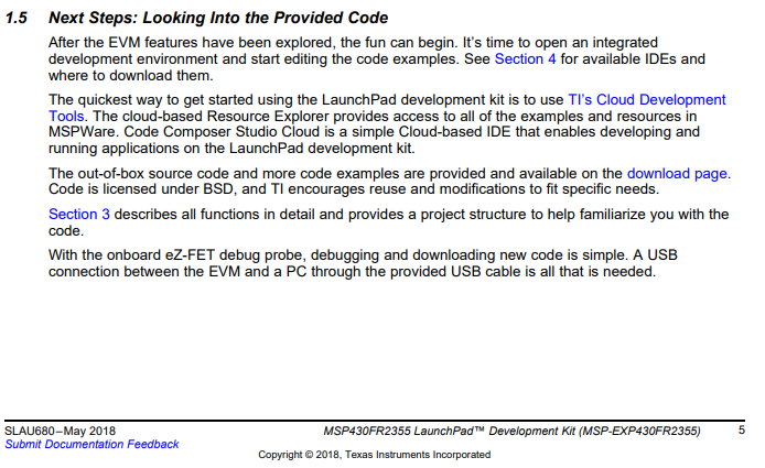

    Regarding the sine wave generation, have you read through the MSP430FR2355 LaunchPad™ Development Kit (MSP-EXP430FR2355) User's Guide? I took a quick look and searched for "sine" and discovered that the Out-of-Box demo code already supports this. Plus, you can also find that source code linked in the User's Guide. That's a good place to start.
