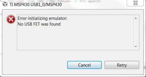

When I try to use my old MSP-FETU430IF with CCSv9 I get the "No USB FET was found" CCS error. I;'m using Windows 7 Pro and CCS  Version: 9.0.1.00004. I have confirmed that the MSP-FETU430IF shows up in device manager. Is this tool still compatible with CCSv9?
See below screenshots.

    I just tried a MSP-FETU430IF with CCS 9.0.1.00004 under Windows 10 Pro and was able to connect to a MSP430FR5969. I.e. the tool still appears compatible.
    In the device manager the tool is appearing as "MSP-FET430UIF - CDC":
    Whereas on your computer the tool is reported as "MSP-FET430UIF - VCP".
    From memory:
    a. Old MSP-FET430UIF firmware used to operate the USB port as using the VCP protocol, which was changed to CDC in later versions.
    b. CCS used to be able to automatically upgrade the firmware from VCP to CDC, but maybe CCS 9 no longer allows that. Will investigate.

    I chose CCS v6.2.0 to perform the downgrade as CCS 7, 8 and 9 installations no no longer had the downgrade script.
    3. Windows Device Manager is now reporting "MSP-FET430UIF VCP".
    4. Attempt to use CCS 9.0.1 to connect to the MSP-FET430UIF and get the dialogue:
    Selected "Update" on the dialogue.
    The Update is successful and CCS 9.0.1 can use the MSP-FET430UIF. Windows Device Manager show the tool as again "MSP-FET430UIF CDC".
    This confirms that CCS 9.0.1 with TI Emulators 8.3.0.00003 and MSP Debug Probe drivers 9.0.1 is still able to upgrade a MSP-FET430UIF from VCP to CDC firmware.
    Given the above investigation I can't explain why you get that error. Can you try an older CCS version such as CCS 6.2 or MSP430-FLASHER to see if they can connect to the MSP-FET430UIF?
  • Thank you for the excellent analysis and response. I was able to upgrade the MSP-FETU430IF using MSPFlasher. I installed MSPFlasher v1.3.20 and used the following command to upgrade the firmware:
    MSP430Flasher -n NO_TARGET -s
    The MSP-FETU430IF now shows up as a CDC device in Windows Device Manager and CCS v9 is able to communicate with it.
