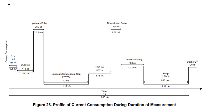

i am working on a new design for ultrasonic water flow meter. i use MSP430FR60431 for metering.
datasheet mentioned that 3-μA overall current consumption with 1 set of results per second which means about 10.8uA per hour.
these numbers will consume our battery in about 3 months only.
other manufactures for water meters grantee battery life time for about 10 years!!!!
is there any missing data on my calculations?
please help me in that
thanks
  • Hi
    The 3uA is come from our water meter EVM embedded msp430fr6047 that is the same family with MSP430FR6043. More detail http://www.ti.com/lit/ug/tidudn0/tidudn0.pdf You can check you hardware compare with our EVM to see if any other power consumption on your board.
    But even with 10uA, that is possible  to make the battery life for 10 years. For most popular use battery in water meter is 18650 which have 2600mah.
    2600/(10*10^-3)=260000h   260000/24=10833 days 10833/366=29years
    Which kind of battery do you use?

  • Hi Ahmed
    Thank for your trust. I have some questions about your point
    Have you read the section of 3.2.2.5 of the this document http://www.ti.com/lit/ug/tidudn0/tidudn0.pdf ?
    The average of the current is 3.83 uA in the picture 26
    I don't know what's meaning of " if the system consumes 3-μA overall current consumption with 1 set of results per second which means 10.8-mA, not 10.8-μA". Why it is 10.8mA? Can you tell me how you get it?

  • No, that is not you the way you calculate.
    You can see the meaning of the mAh:
    For instance, a 3000 mAh battery could power a device drawing 100 mA (average current) for 30 hours. A device drawing 10 uA would last only 300000 hours.
    Best regards
    Gary

  • Hi
    Sorry for the confusing here. The 1 set of reading per second is means the sample rate is 1 sps(sample per second).
    Best regard
    Gary

  • Hi
    Please clear what's the meaning of average current here. The average current is regardless with the time.(Please don't multiply 3600) The mAh is use the average current. I afraid you have not fully under stand the meaning of mAh. You can see this page https://www.ubergizmo.com/what-is/mah-milliamp-hours/
    Please watch the video carefully for the meaning of the mAh. Thanks
