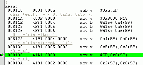

    The choice for this is mainly because the MSP430 processor does not seperate word accesses that cross word boundaries into multiple accesses (i.e. like the ARM can).  Thus if you make a word access to an odd memory address, the second half of the word comes from the previous address instead of the following address.  For example, I created the following code
    Thus, t0 and t1 read words out of the array with t0 reading the word aligned value and t1 reading the byte aligned value (we know that test starts on a word boundary as it is on the stack and the stack is forced to word aligned values).  The transfer of t0 and t1 to t3 and t4 merely forces the compiler to do the accesses and make them available to the debugger.
    The generated code is
    The code at address 812A loads from an address that is an even number of bytes offset from the stack pointer so we know this is a word address as we expected.  The code at address 8130 loads an address that is an odd number of bytes offset from the stack pointer so we know this is not a word address, again as we expected.  However, take a look at what the cpu loaded into the respective variables
    Since the MSP430 stores variables in little endian format, the value read into t0 is correct as 0x00 was in the addressed byte and 0xAA was in the  following byte.  However, the value loaded into t1 should have been 0x55AA but it is the same as that of t0.  This is because the MSP430 forces the LSB of an adddress to zero for word accesses so the attempt to read a word starting at address 0x2BF5 resulted in a word read of address 0x2BF4 which is the same address that was used to load t0.
