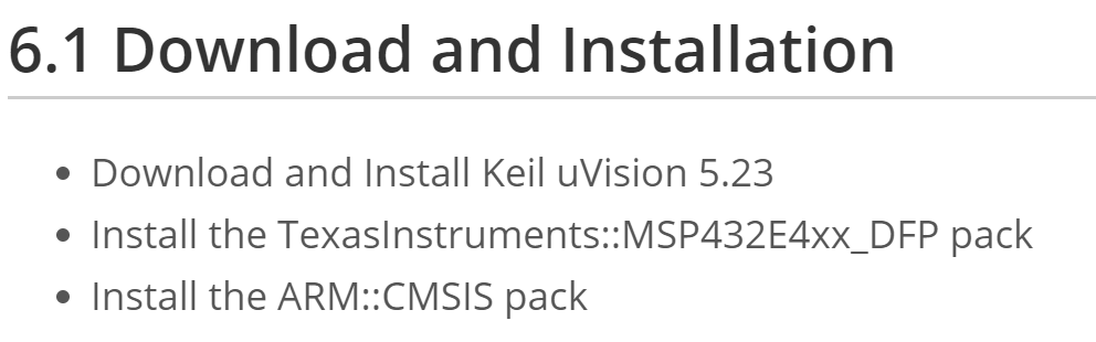

Hello I installed TI MSP432E4_DFP package via Pack Installer on uVision (Version 5.25.2.0) and the simplelink MSP432E4 SDK like description on quick start manual. I got no errors and it seems to be fine But after opening any simplelink SDK uVison Keil example project (for example: ti\simplelink_msp432e4_sdk_3_20_00_10\examples\nortos\MSP_EXP432E401Y\driverlib\empty\keil) I got the following building error: "L6024U: Library msp432e4_driverlib.a contains an invalid member Name". What could be the Problem?
When I use instead the same example project for CCS in CCS v9.1 (for example: ti\simplelink_msp432e4_sdk_3_20_00_10\examples\nortos\MSP_EXP432E401Y\driverlib\empty\ccs) everthing works fine, no building problems?
Maybe the driver lib for keil (ti\simplelink_msp432e4_sdk_3_20_00_10\source\ti\devices\msp432e4\driverlib\lib\keil\m4f) is not working? Or is it because I'm using TexasInstruments.MSP432E4_DFP.3.2.6.pack not TexasInstruments.MSP432E4_DFP.3.1.0.pack?
