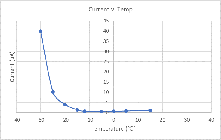

We are using an MSP430G2333 in our design. We have had issues with high sleep current at cold temperatures (minimum of -30 deg.C). Through further testing, we found that the source of all of this excess current at cold temperatures is the MSP430G2333 (DVCC pin). The following is a plot showing an example of this high sleep current that we see in our board. The current was measured at the power source in this test.
To determine which part of our design could be causing this high sleep current, we decided to run a series of tests. The first test was to narrow out the possibility of the problem being in the MSP430 device itself. We programmed an MSP430G2 LaunchPad (MSP430G2553) with example code from CCS (msp430g2xx3_lpm3_vlo.c), disconnected LED1, and ran a test measuring the overall current at cold temperatures, down to -30 deg.C. We found that this test also resulted in high sleep current. The following is a plot of the results of this test.
Why are we seeing this increase of sleep current as temperature decreases?

    We tested the LaunchPad with this code modification, down to -30 deg C. We saw the same results as the test prior: Current increased steadily up to about 70uA.
    Additionally, the code for our PCB was also modified, as Tyler mentioned. The unused GPIOs are now terminated as inputs and held low by the internal resistors. We ran a test after making these code changes, once again down to -30 deg C. In this test, we saw an improvement in the sleep current values, but the issue still remained. We saw a maximum sleep current value of about 20uA at -30 deg C as opposed to the previous results (before code modification) of about 40uA. However, we would hope for more of an improvement than that, of course.
    At this point, we wanted to confirm that moisture was not an issue in these tests. We repeated the test above, with our same PCB (still with the modified code). However, this time, we set the temperature chamber to sit at hot temperatures (60 deg C) for a while, so that it would dry out the chamber prior to running our cold-temperature test. We also added a bowl of silica gel desiccant to the temperature chamber to absorb possible excess moisture during the test.The results of this were the same as the previous test. The sleep current, again, reached about 20uA at -30 deg C. Based on this result, it seems that moisture is not a problem in our tests.
