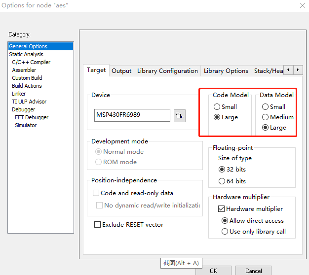

  • Change  IDE, and try agagin.  I think it 's more like a IDE setting issue.
    Use IAR for MSP430 (Large Mode) or CCS.

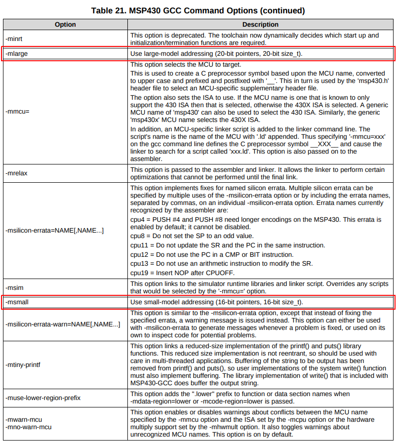

  • Thanks for the feedback but if the settings are a problem then I'll have to fix my compiler flags. I transitioned my project away from CCS, so I now have a makefile that builds my project and then I use gdb to load, execute, and debug. I did some digging it seems that the compiler flag equivalent of the settings you highlighted are addressed here:
    My build currently uses the "-mlarge" flag so based on my understanding, I should have access to the full memory range using 20-bit pointers.

  • Update:
    blink.c example:
    I am able to write to HIFRAM in the example application now. I was using the makefile that msp430-gcc includes in that example and overlooked the fact that it didn't include -mlarge by default. The note in your other comment about pointer vs data size is totally correct, I'm not sure what I was thinking there.
