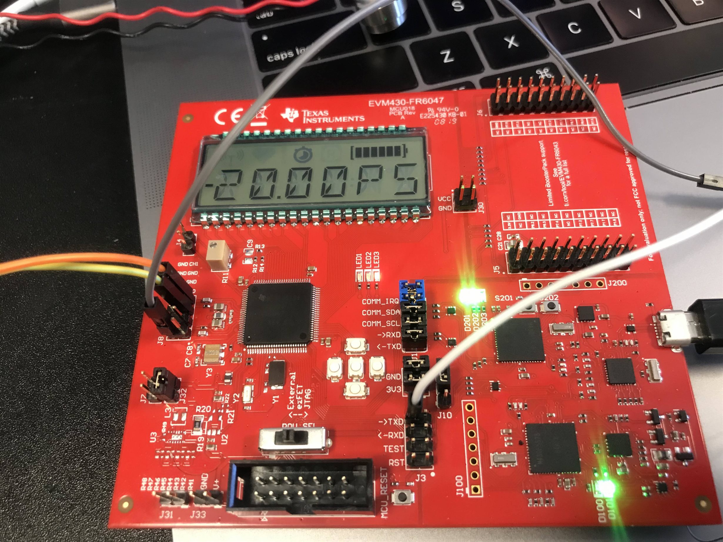

  • Just to be sure, the UART wires are taken out from J2 Tx pin. I wanted to rule this doubt out as well.
    I also tried with a Beaglebone, but unfortunately, it was the same there too.
  • Yes, this should be on J2 TX pin.  Be sure that you are connecting your wire to the side of the header closest to the TXD silkscreen.
    To check if the code is running properly, you may also want to place the jumper on J2 TX and use the USB interface with a Windows PC and terminal application.  Just as a quick sanity check.
  • Yes, I have attached the pins as said, could you verify the jumpers and the connections? I wanted to read the data on the linux terminal.
    The white wire is the UART Tx wire.
    The gray wire is connected to the ground of beaglebone.
    Orange and yellow wires are connected to the positive and the negative of the Steminc ultrasonic sensors.
  • Jumper configuration looks good.  TXD connection is correct.  I'm not sure that it would make a difference, but you may want to try using a ground point from the MCU ground instead of USS ground.  There is GND available on J33 or J30 that could be used.
    Were you able to test placing the TXD jumper on J3 and using USB to transmit to a PC?  Another test could be to connect the TXD pin to a oscilloscope or logic analyzer to verify the UART signal is there.
  • The TXD pin to oscilloscope is generating a proper square signal. So, is the UART on the EVM working fine?
    And the silkscreen on the EVM just shows -20.00PS for the DTOF values, when the 1 MHZ STEMINC ultrasonic sensors  are connected to it ( not to a pipe).  is that right?
  • Ashish,
    Yes, that sounds like the UART is working.  Connecting to a PC via USB could confirm that the data looks correct, but it sounds like it is at least transmitting data if you see the signal on oscilloscope.
    If it is staying fixed at -20ps, this is not correct.  The DToF should be moving around some with each measurement.  What is your setup?  Are you trying to measure flow rate or something else?  1MHz transducers would need to be in water to receive a proper signal as the attenuation in air would be too high.  Are you able to receive a proper ADC signal using the Design Center GUI?  The first step should be making sure you can obtain a good ADC signal.  The FAQ below has some good pointers on getting this started.
