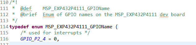

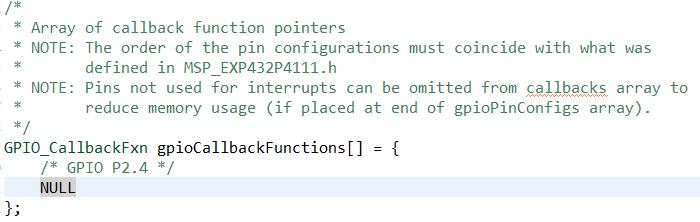

I have a GPIO Interrupt on P2.4 with RTOS, the code is:
  GPIO_setConfig(P_GPIO_P2_4, GPIO_CFG_IN_PU   | GPIO_CFG_IN_INT_FALLING);
  /* install Button callback */
  GPIO_setCallback(P_GPIO_P2_4, gpioFpgaFxn0);
  /* Enable interrupts */
  GPIO_enableInt(P_GPIO_P2_4);
  /* Start BIOS */
  BIOS_start();
  return (0);
 *  Callback function for the FPGA interrupt to be read.
void gpioFpgaFxn0(uint_least8_t index)
    Semaphore_post(Semaphore_handle(&FPGA_spiTaskAlert));

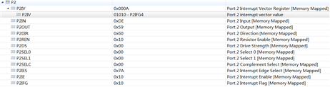

And I see the REG:
it has the P2IFG = 0x10, P2IV = P2IFG4.
But the code can not goto the Callback function......
What should I do next ?
