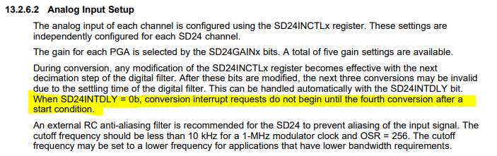

    - It seems like you are waiting until the 4th conversion (SD24INTDLY=0), is that right?

  • >It seems like you are waiting until the 4th conversion (SD24INTDLY=0)
    Don't you have that backwards?  I thought SD24INTDLY=0 means that
    I am NOT waiting for the 4th conversion.  Anyway, I do NOT have that
    bit set, because I am running continuous conversions until the end
    of time so I don't care if the first 3 are wrong.  Um, maybe I don't
    properly understand SD24INTDLY at all? :-)
    My understanding is that for an OSR of, say, 128, the A/D converter
    would average 128 samples.  If SD24INTDLY=0 then it would take 128
    samples and average them and then report the result to me in an
    interrupt.  If SD24INTDLY=1 then it would take 131 samples, and then
    average samples 4 thru 131 and report the result to me.  I assume
    this SD24INTDLY behavior would be the same whether I was using
    single conversions or continuous conversions (in the latter case,
    the delay wold be unnecessary and wastful).  Do I have this wrong?

  • Hi Nick,
    A few things:
    It's a bit confusing, but having SD24INTDLY=0 means that you are waiting until the 4th conversion to start generating conversion interrupts:
    This is generally used whenever you are starting up the ADC or whenever the SD24INCTLx register is modified (as mentioned above) to reduce error and provide better accuracy.

  • >SD24INTDLY=0 means that you are waiting until the 4th conversion
      I thought that was simply a documentation error!  It seems totally
    BACKWARDS to me, but I'm gonna believe you. :-)  Besides, that would
    only affect accuracy, not "cross-talk".
