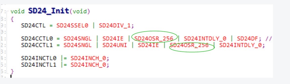

2)SD24_init is as following:(SD24OSR_1024 is better,sampling data is more stable.but when we finished a sample cycle(20ms),it looks like more than 300ms,then these sampling data shouldn't be right.)

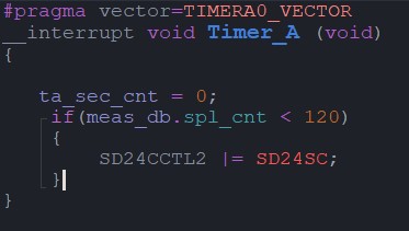

3)we set TA timer as 50*120 hz.(as following)
4):TA's ISR is STARTING sd24 ADC covert.

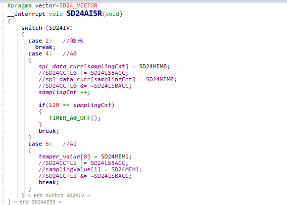

5)SD24 ISR is like following:(we just get high 16bit,ignore low 16bit)

1. why you configure the SD24INTDLY_0 in SD24CCTLx register ? I know that have no affect with the code but we should avoid this.

1),yes.here is some mistake .i'll corrected it.
