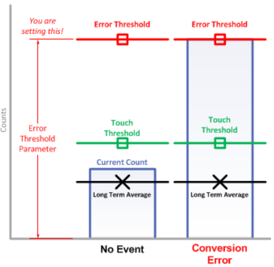

Regarding to Max Count Error on MSP430FR2633, my customer is asking a question.
They face Max Count Error on their new original touch sensor board.
Their old original touch sensor board is not occurred error.
The different between old board and new board is touch sensor construction only.
(Question)
They will re-configure error threshold as new touch sensor board.
Other, should they re- configure touch threshold?
Or should they re-configure other parameter?

    What is the max count setting in the software right now?

    Error threshold is 8191(maximum count).

    It seems customer tune parameters too sensitive.
    What is the conversion count and conversion gain setting?
    Would you please ask customer to provide the User-Config.c file to us?

    Just now I have gotten User- Config file from my customer.
    Could you please confirm with this?
