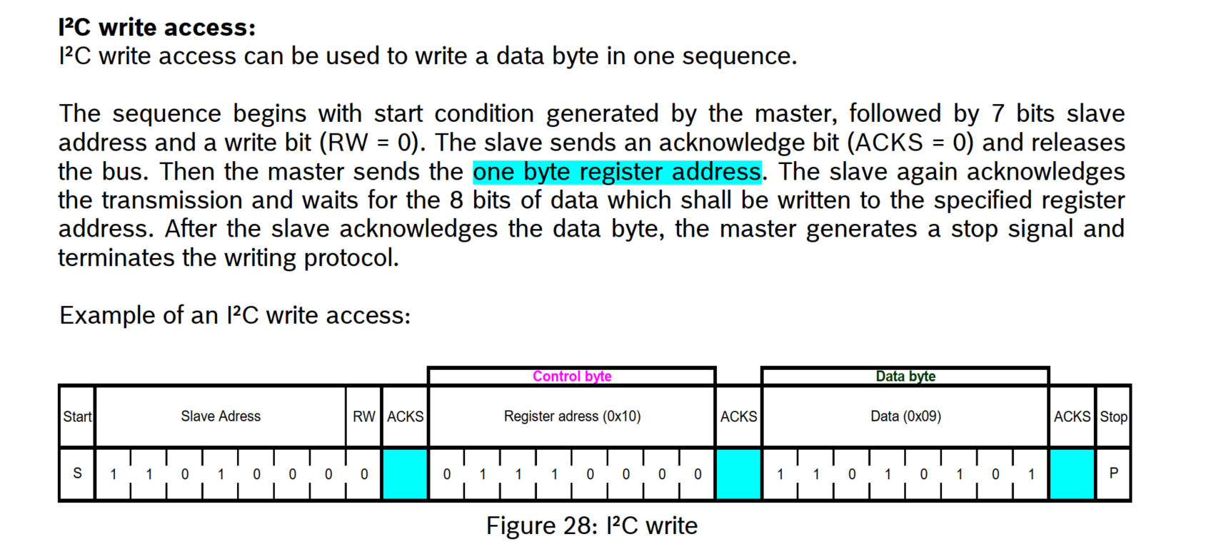

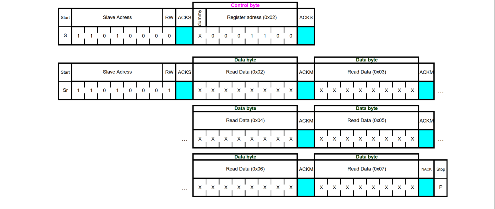

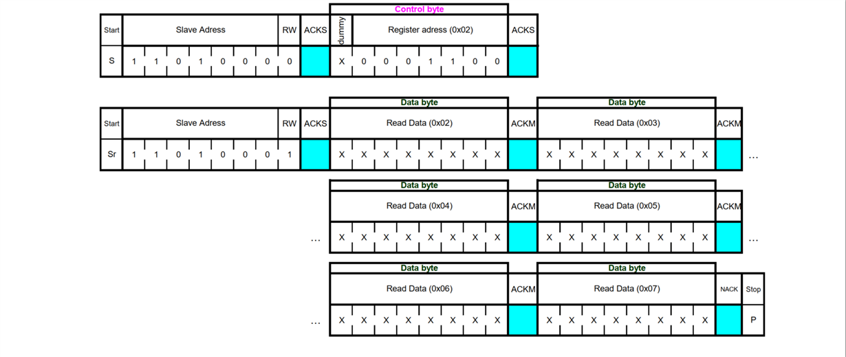

  • For receiving and sending data with I2C protocol, I have defined two functions for I2C write and read. The chip I am working it, BMI160, accepts data on I2C bus like what is defined in below:
    For I2C read access:
    I have configured the read/write functions like below:

    2- I2C write function:
    int8_t user_i2c_write(uint8_t dev_id, uint8_t reg_addr, uint8_t *reg_data, uint16_t len)
        int8_t rslt = BMI160_OK; /* Return 0 for Success, non-zero for failure */
        /* Transmit interrupt comes from i2c write function*/
        readModule = 0;
        /* Load Byte Counter */
        TXByteCtr = len;
        /* Making sure the last transaction has been completely sent out */
        while (MAP_I2C_masterIsStopSent(EUSCI_B0_BASE) == EUSCI_B_I2C_SENDING_STOP);
        /* Set Master in transmit mode */
         MAP_I2C_setMode(EUSCI_B0_BASE, EUSCI_B_I2C_TRANSMIT_MODE);
        /* Sending the initial start condition *///And register address.
        MAP_I2C_masterSendMultiByteStart(EUSCI_B0_BASE, reg_addr);
        while(TRANSMITFLAG);
        TRANSMITFLAG=1;
       // MAP_Interrupt_enableSleepOnIsrExit();
       // MAP_PCM_gotoLPM0InterruptSafe();
        return rslt;
    3- I2C read function:
    int8_t user_i2c_read(uint8_t dev_id, uint8_t reg_addr, uint8_t *reg_data, uint16_t len)
        /* Transmit interrupt comes from i2c read function*/
        readModule = 1;
       /*Number of bytes to be received*/
        NUM_OF_REC_BYTES = len;
        MAP_I2C_enableInterrupt(EUSCI_B0_BASE, EUSCI_B_I2C_RECEIVE_INTERRUPT0);
         /* Send start and the first byte of the transmit buffer. We have to send
          * two bytes to clean out whatever is in the buffer from a previous
          * send  */
         //MAP_I2C_masterSendMultiByteStart(EUSCI_B0_BASE,reg_addr);
         MAP_I2C_masterSendMultiByteNext(EUSCI_B0_BASE, reg_addr);
         /* Enabling transfer interrupt after stop has been sent */
         MAP_I2C_enableInterrupt(EUSCI_B0_BASE, EUSCI_B_I2C_TRANSMIT_INTERRUPT0);
         /* While the stop condition hasn't been sent out... */
         while(!stopSent)
         stopSent = false;
         return rslt;
