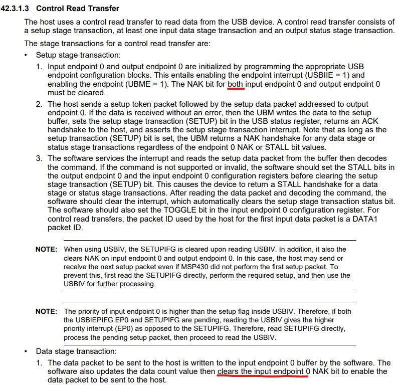

    • I would like to see if this behavior persists if we follow the User's Guide's instructions in 42.3.1.3 Control Read Transfer in http://www.ti.com/lit/ug/slau208q/slau208q.pdf
    • There are some differences such as clearing NAK for both IEP0 and OEP0.

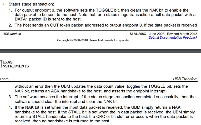

    • There are also 2 NOTEs in this section that could be helpful to you. Both also seem to address potential timing issues.
    Ack, maybe I missed something. I'll take a look.

    If I may add in, please notice that the instructions for control read requests are different for every stage. Clear both NAKs for a Setup Stage, only IEP0 NAK for Data Stage, and something different all together for Status Stage.

    It looks like I missed something important: You're only expected to clear _both_ NAK bits during the Setup Phase. After reading a packet and clearing the SETUP Received Interrupt flag, does the core automatically set the NAK bits on both endpoints again? My reading of the manual is yes. Anyways, this changes a lot of stuff around in tinyUSB, and I need some time to think.

  • I did a bit of testing myself, and here's what I found that may have contributed to some misconceptions of my own. Consider this a "post-mortem analysis":
    • Clearing SETUPIFG does not set NAK in USB{O,I}EPCNT_0. You must clear these manually, otherwise upon immediately reading USBVECINT and getting 0x20 (SETUP packet received) back, you have two live xfers on the control pipe just waiting for the host to send an IN or OUT packet.
      I wish this was more clear in the manual one could make the argument that "since it's never stated that SETUPIFG sets NAK on IN/OUT EP 0, assume that it doesn't." What threw me off is that in the Data Stage Transaction of the manual page you linked me, the first step is to explicitly clear the NAK bit; this made me think that SETUPIFG does it for you, because why would this be mentioned otherwise?
    • When SETUPIFG is cleared, and assuming a 16 MHz CPU clock, a ZLP IN xfer can (and pretty consistently does) complete in as few as the following two C statements. This threw me off, because it feels like that's far too short a duration for the xfer to complete. But then again, I don't have a schematic :). I have attached two C code snippets I used for testing below- assume a 16 MHz CPU clock.

      The random STALLs disappeared completely when I added code to clear EP0 NAKs every time a bus reset occurs, and to always SET EP0 NAKs before clearing SETUPIFG.[1][2] Ideally I should also be clearing EP0 NAKs after the Status Phase is over, but tinyUSB currently has no hooks to do that. I'll talk to the maintainer about this.
    Tentatively, I mark my issue as resolved, but I still want to do testing w/ EP0 NAKs after the Status Phase, which could be a few days/weeks. Is it common courtesy to mark the issue as resolved anyway at this point?
    Footnotes
    1. Actually for the sake of full disclosure, adding just code to "always SET EP0 NAKs before clearing SETUPIFG" and keeping my code to set NAKs during a bus reset as-is is also sufficient to prevent the STALLs. But I should do this the right way :).
    2. Ironically enough, with the changes above, I was able to capture traces where the host just stopped sending packets after the intended protocol STALL. I wish I captured a screenshot! They went away when I reset my Launchpad/debugger however. I'm not about to debug the Windows USB host stack to figure out why it gave up :).

    • The MSP430 USB stack as you can see doesn't really follow the stages. It's neither right nor wrong, the software architect at the time decided to do it this way. So there is not a clear moment where the stack clears both NAKs as we are looking for. It's a very deliberate and controlled program flow, although I will point your attention that the functions like usbClearOEP0ByteCount and usbSendNextPacketOnIEP0 alsoclear the NAK even though it is not explicitly noted.
      • EP0 NAKs are also explicitly cleared in USB_reset(), as you mentioned a similar situation in your own code.
    • On all the other points you mentioned, I agree! Thanks for the "post-mortem analysis" that future engineers can use when they refer to this thread.
