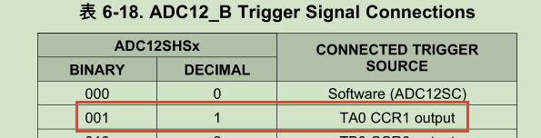

hello,everyone:
I want to implement a function: timer triggers adc module to implement Repeat-Sequence-of-Channels Mode. However, the problem now is that the Sequence sampling interval is either the timer turnover cycle or adc sampling conversion interval.Below is my software configuration and function diagram

  • Use CONSEQ=1 and MSC=1.
    In the ISR, you'll need to toggle ENC (low, then high), or the ADC will stop. [Ref User Guide (SLAU367o) Fig 34-9.]

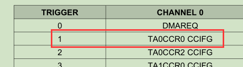

    I have a try with DMA.TA0 CCR1 trigger ADC12,TA0 CCR0 trigger DMA0.I coudle control the interval betwen CCR1 and CCR0.in fact,it does't work my way.

    DMACTL0 = DMA0TSEL_1;//DMA0TSEL_2:TA0CCR2 CCIFG |DMA1TSEL_26:ADC12 end of conversion

  • In what way does it not work? It doesn't transfer the data? Or the program locks up?
    I'm pretty sure you need to clear DMAIFG in the ISR, either with "&=" or by reading DMAIV. The symptom here would be a program lockup.
    Ordinarily I would expect to see DMA0TSEL_24 for the ADC [Ref data sheet (SLAS590N) Table 6-10.]  I think DMA0TSEL_1  with OUTMOD=7 will trigger the DMA and the ADC at the same time so you might get half-done results.
  • My initial idea was that the timer would automatically trigger ADC to perform sequence sampling, ADC sampling would trigger DMA, and 20 sequence sampling would complete to produce DMA interrupts.At the moment, my idea of MCU is unrealisable, so I give up on practical DMA.
  • Yes, you can do all that except the 20 sequences -- you want the SA to start over for every sequence, but the DA not to, and (looking through all the charts) I don't see any mode that does that.
    I'm pretty sure that if you use DMADT=5 you can arrange to only set up once, and let the DMA repeat itself, but you still get one interrupt per sequence.
