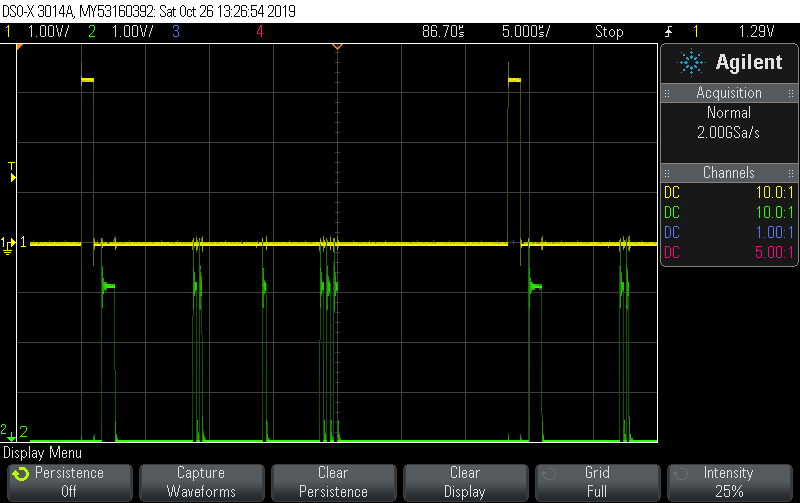

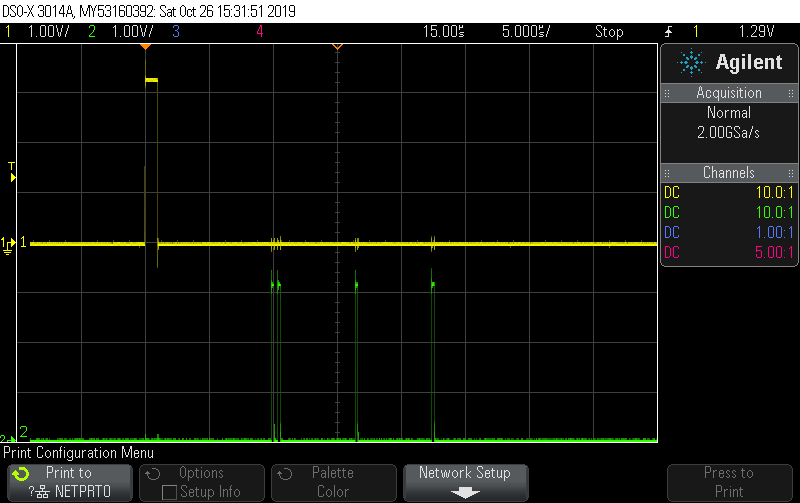

    I assumed to get on the scope a picture of: (where upper yellow trace is P2.0 (TB1.1) output, and lower green trace is P6.6):
    But i was surprised to find out that only rarely i get this picture (taking multiple snapshots with the scope), in most of time i get this:
    Indicating missing sample of channel A2.
    I have no clue of what is happening - can you help?
    Best regards
    Ofer Zilberberg
  • Sorry, yes you're right about INCH being re-set at the end. I must have been thinking about some other chip.
    The things I'm looking at:
    1) If a conversion takes 5usec, that's how long you have to pick up MEM0. That's about 5*24=120 CPU clocks. That sounds like a lot, but it goes quickly, and I would say your ISR is a bit on the heavy side.
    This sets up a race. Your ISR can drift forward in time without incident (you can kind of see that in the scope trace) until it overruns something.
    2) You're doing the ENC toggling when INCH==0, which is (nominally) during the conversion of channel 0. Depending on how the race in (1) above is running, this might or might not actually be during the conversion. UG Sec 21.2.7.6 makes this sound benign, but I'm not sure I would want to push it.
    3) Are you using LPM? The wakeup times can make a difference when you're pushing the limits.
    If I were doing forensics, I'd dig through the assembly code and see what cases could arise. Since you're still in development, I'd say "Fix: Avoid". I.e some subset of:
    A) Measure how long your ADC ISR takes, e.g. by wiggling a GPIO on entry and exit. Since you're using ^= on P6.6 you might be able to get triple-duty out of it.
    B) Lighten up your ADC ISR
    C) Do the ENC toggling when INCH==2
    D) Slow down your ADC conversions just slightly (plus some Engineering margin).

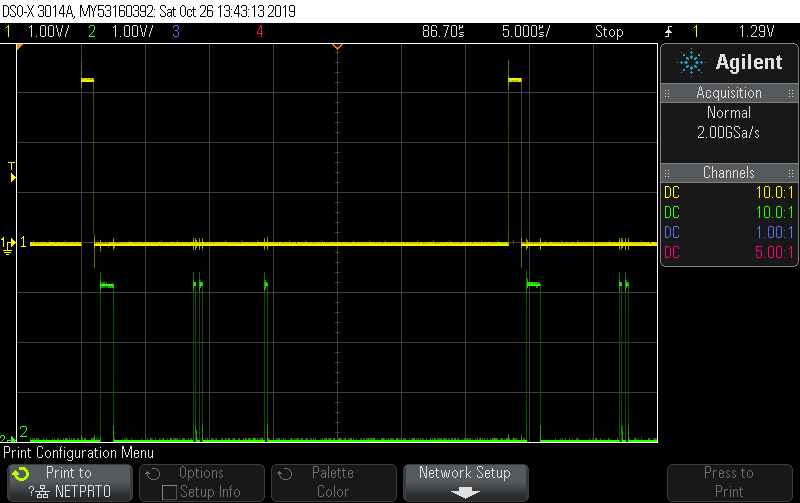

  • Update
    I have figure up that i probably have a problem with the time it takes the ADC interrupt to execute, compared with the time of the ADC conversion sequence.
    I have slow down the conversion sequence time by enlarging the sample time (using ADCCTL0 |= ADCSHT_1 | ADCMSC | ADCON; instead of ADCCTL0 |= ADCSHT_0 | ADCMSC | ADCON;).
    I have also eliminate completely the TB1 interrupt leaving only the ADC interrupt running.
    Now i get stable 3 sequential readings but not in the correct order:
    Apparently, channel A0 is converted 2 times.
    How can it happened without a sync ? (i have tried to enlarge the sampling time with same results).
    Thanks in advance
    Ofer Zilberberg
  • How long does your ADC ISR actually take?
    Are you still toggling ENC when INCH==0?
  • Hi Bruce
    Thank you for the prompt answer - it helps to solve the case.
    1) I have used a global counter for the channel count as you suggested.
    2) Apparently X=inchx does not performed as the flow chart suggested, rather after flipping the EMC bit, therefore I have located another interrupt (Using CCR2) to be placed  after the 3 conversions to take care of the flipping, leaving the ADCISR only with storing the MEM0 data.
    I achieve 5uS between samples (7usec from the TB1.1 to first ADCINT and 5uS after that).
    Thank you for your patience and deep understanding, May the force be with you :)   .
    Best regards
    Ofer Zilberberg
