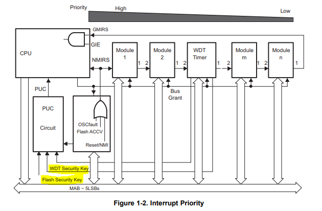

  • The manual doesn't provide a lot of detail on the interrupt system except to show that the modules are chained together and this defines their priorities. Even without circuit details it seems unlikely that this would cause a reset. A NMI perhaps. Do you have a NMI handler? If not, add a simple one so you can see if it gets triggered.
    A spurious NMI is just as nasty a bug as a reset of course.
  • On my board I use RST_NMI_SBWTDIO pin connected to a pushbutton and an RC network for external reset. The pushbutton is used to trigger my NMI handler. In my NMI handler only NMIIFG event (from pushbutton pressed or released event) is handled; the other flags (OFIFG and ACCVIFG) are only cleared, if set, because both ACCVIE and OFIE are set to 0.
    RST_NMI_SBWTDIO and TEST_SBWTCK pins are also used for 2-Wire JTAG (Spy-Bi-Wire) program/debug interface..
    When the reset issue occurs, NMI handler is not triggered.

  • Hey Vagni,
    Very sorry for the delay from my side.  Are you still having this issue?  Do you have some code that repeats the issue that you can share with me?
    I also looked back at the system reset sources in the user's guide, and it appears that WDT and Flash PW violations will also directly cause a device PUC.  The WDT flag is in the IFG2 register that you are viewing above, but it actually appears that a Flash violation sets bits in the FCTL3 register.  Specifically the KEYV and ACCVIFG bits.
    Can you also check these bits to see if the reset is coming from a flash password violation?
    JD
