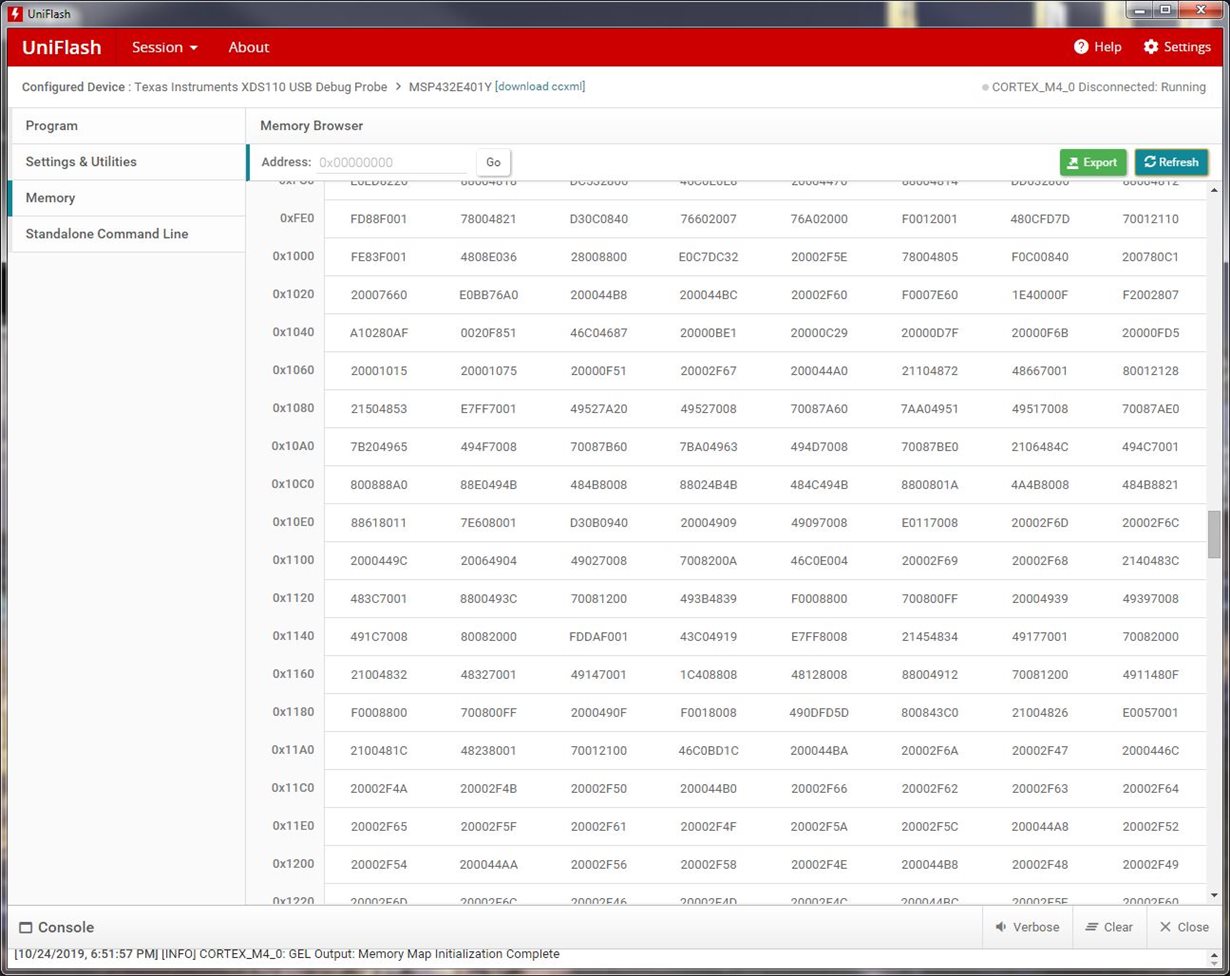

I'm still struggling with the EMAC bootloader functions on the MSP432E4.
I've now been successful in loading a custom firmware onto the device via emac bootloader.   I can then even trigger another update request through receipt of the magic packet, and have the board initialize a tftp read request.   However this is where things go sideways.
The board will then pull in the file but then bricks itself and can only be recovered by perfoming a mass erase to reprogram.   I'm not really sure what may be causing the issue and am now at a loss.
Here is the software update task function that monitors for a successful receipt of magicpacket on UDP port 9.  The getFirmwareUpdateSatus() function just returns a boolean value that is set by a monitor thread that checks for the magic packet.   This all works, but I put it here as maybe there is something amiss with the sysClock variable.

in case it is helpful I've also included my linker cmd file, the resultant .map, and the system_msp432e401y.c and startup_msp432e401y_ccs.c files.  The last two I pulled straight from the boot_emac_flash_app_magicpacket_update_MSP_EXP432E401Y_nortos_ccs example project without changes, so maybe there is something in there that is an issue.
Thanks for any help you can provide.

  • Looking at this further, it appears that the when I load the same image a second time, the memory map is completely different.   What in the bootloader routine might cause this?
    The image is first loaded on top of the boot_emac_magicpacket example, and thus loads correctly.   The second time it is obviously done making calls to it's own program as specified above.   This appears to load the file incorrectly for some reason.
    Just for the heck of it, here are snapshots of the memory registers taken from uniflash showing the difference, they should be identical I would think.
    Here's the memory address reads of the good load, everything is working in the program
    And here is the memory read of the subsequent load where the MSP is now bricked.
