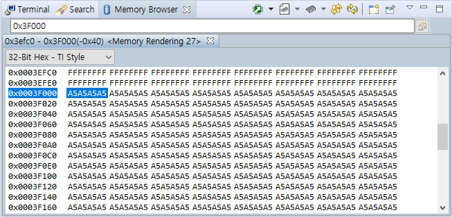

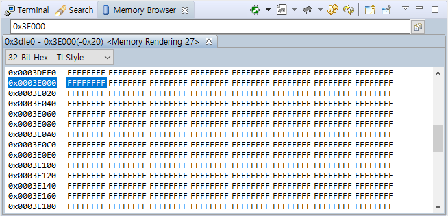

I am testing erasing flash memory with "flash_mass_erase.c" in example. it works fine by itself in CCS.
To put it in my RTOS application, I amended two things:
  1. change main() to memwr_cmd() to make it callable function
  2. add sem_post(&semUART0) statement for process sync.
In the first run, I can find that BANK 1 SEGMENT 30 (0x3E000~0x3EFFF) and BANK 1 SEGMENT 31 (0x3F000~0x3FFFF) have correct value as expected.
In the first run, memwr_cmd() runs well.
In the second run, process sync has some problem.  I have another processes with same scheme and they runs very well.

    /* Performing the mass erase again. Now, since we protected Sector31, only
     * Sector 30 (0x3E000 - 0x3EFFF) should be erased. Set a breakpoint
     * after this call to observe the memory in the debugger.
    if(!MAP_FlashCtl_performMassErase())
        while(1);
