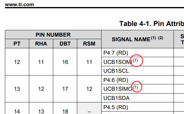

What are the available pins for UCB1 on the MSP430FR2355?
We see SOMI/SIMO listed for RSM.11/12 in Table 4-1:

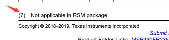

But Table 4-2 indicates UCB1 is not exposed for the RSM:
Is UCB1.SPI exposed for the RSM package?
