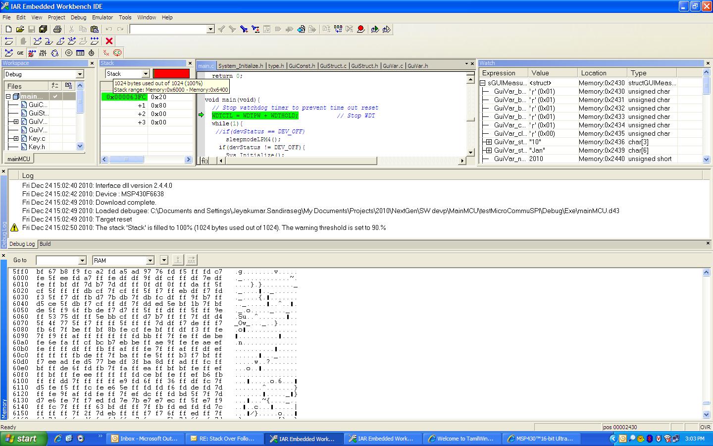

Whenever I download simple program the below error message keep prompting up with IAR log window.
Can I check is there any additional setting need to be done in IAR workspace?
Wed Dec 22 16:01:49 2010: The stack 'Stack' is filled to 100% (1024 bytes used out of 1024). The warning threshold is set to 90.%
looking foward for your reply.

  • The problem is not related to any issue with the MCU or the compiler/linker/etc. The issue is with how your application uses resources.
    Can you confirm the contents of the stack are actually in use (use the memory window)? IAR will fill the stack with the pattern 0xCD. If your stack is full, then it will have different values for the stack.
    The only time I've ever had this warning appear at the beginning of main was when I had a Power Up RAM test run before main for a medical product I developed. In this case, the stack was written with values other than 0xCD, which made IAR think the stack was full.
    If you are not familiar with your application, it could be that it is doing something similar. You could also try setting a breakpoint at your reset vector to see what the MCU executes before main starts.
  • Dear darkwzrd,
    Pls see below on the printscreen for IAR window.
     The data pattern is not found. Is there any additional settings need to do in IAR?
     The options are set as usual.  Could you pls advise how to set or where to do the addtional setting if there any ? Thank you.
  • I don't actually know which chip you are using, except that the title of your post is "Stack Over Follow for msp430f663". I will assume you are using an msp430f663x, where x is 0, 1, 2 or 3. Either way, for all of these parts the RAM is the same.
    Based on the screenshot, it appears that your stack range is 0x63FF to 0x6000. This makes sense based on which chip I think you are using. You can see in the memory window that the stack has values in it up to 0x6000. You need to figure out why.

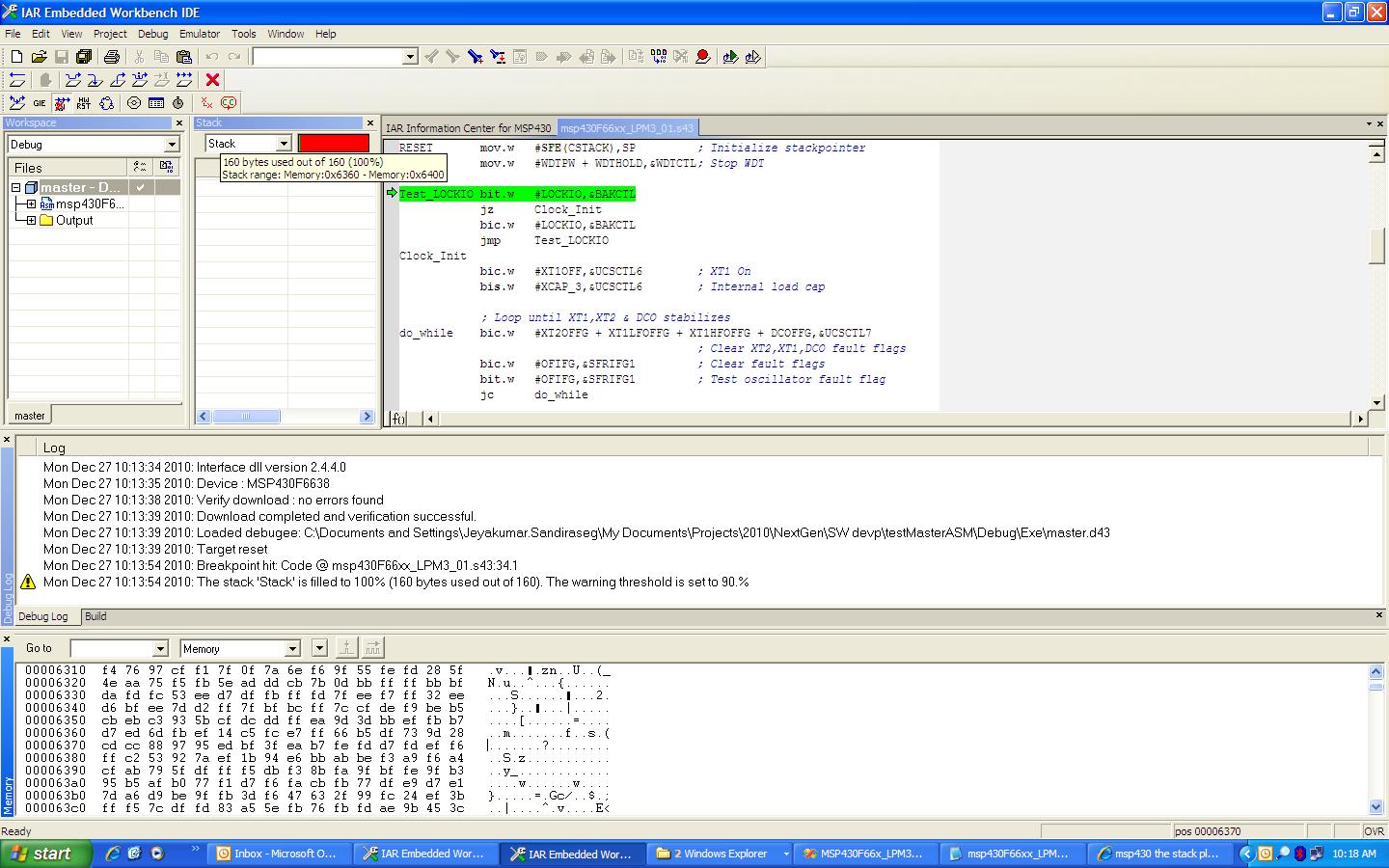

  • Dear Darkwzrd,
    Sorry that I did not indicated clearly in my email. I am using  MSP430F6638.
    Pls see attached Screen shot with a break point just after the rest stack pointer but  unfortunately the same result appears.
    Can you help by trying at your end? let me know if you have the same issue?
  • Okay, I'm a little confused at this point. I've seen two screenshots now, which show different projects. The first one was a project in C with multiple files, and it had a stack of 1KB. This project has one file in assembly and has 160 bytes of stack.
    The stack trace tool is not normally able to track the stack of user made assembly files unless you take special action to help the tool keep track of the stack. This is an advanced feature. It is something I fiddled with a little bit, but ultimately didn't finish because I didn't think it was all that useful.
    If you have a project that has assembly files hand created (and you don't give the stack tool information about how the stack is being used), it won't be able to come up with this information. If the warning bothers you, then turn it off, by disabling the plugin (RightClickProject->Options->Category:Debugger->Plugins->Stack).
    Did you find out what was executing before main in your C Project that filled your stack? If you are running a C Project and you haven't done something special with the startup process, then IAR should load the stack with 0xCD when you first download code to the device using the FET Debugger. If you are doing something special with the startup process, then you can either disable the plugin has shown previously, or you can fill the stack back in with 0xCD depending on what you want to do.

    Today I downloaded some code into the Chronos development kit I've been playing with (CC430F6137), and I ran into your same problem. I found that IAR Compiler 4.21 (what I had installed on my home computer) had this same issue.
    This doesn't happen very often, but I believe that IAR is at fault here. I upgraded to version 5.20, and the issue was fixed. Looking through their change log, I think I found the likely culprit.
    EW21955: The stack plugin detected a failure overflow when using MSP430F66xx devices. The .ddf file now has a correct start ram address which means that the stack initialization no longer results in a failure.
    Just for grins, I did a file diff between the files used for my CC430F6137 and I did find that the RAM range in Version 4.21 was incorrect as well (too bad this one wasn't mentioned in the change log as well)!
    Try upgrading to version 5.20 and see if the issue goes away.
