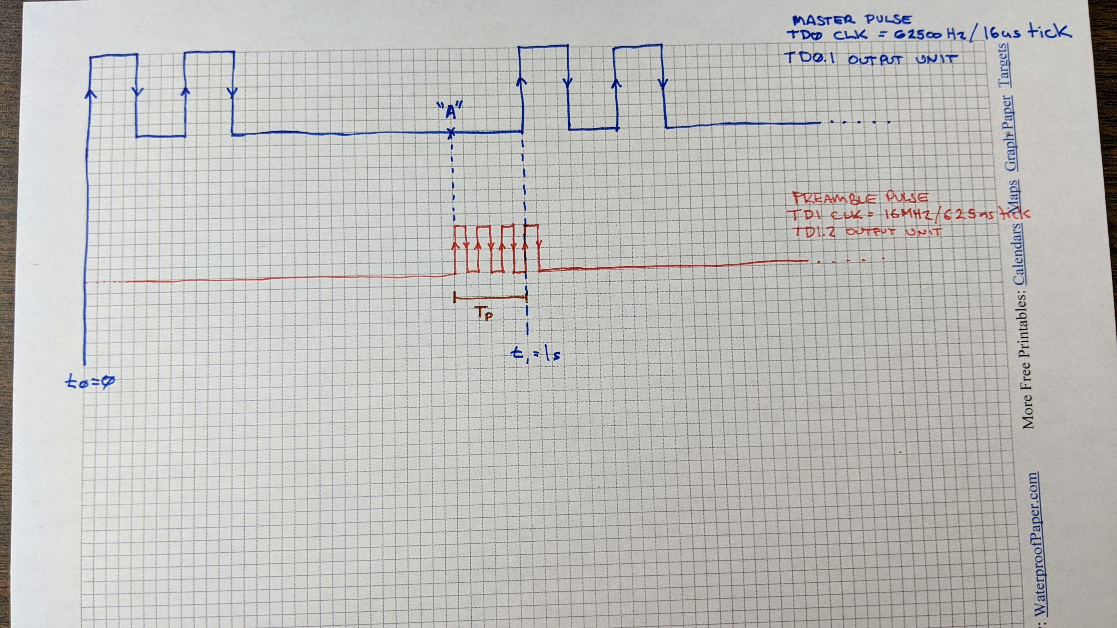

I am wondering what is the most accurate way to achieve rising-edge synchronization between two CCR output modules from two different timers when their timebases are different.   Ideally I want the edges to occur within a few MCLKs of each other, preferably < 10.   Bear in mind this post is a  gross simplification of the overall project, but it gets the basic idea across.   Allow me to first illustrate with a diagram:
The top pulse train is generated by using TD0 and TD0CCR1 along with its output compare unit configured to output on pin TD0.1   TD0 is configured to operate from a 62500kHz clock generated through the usual clock dividers.  The pulse train itself has a period of 1 second;  therefore, a total of 62500 clock ticks of TD0 occur during any single period of this pulse train.   The pulse train timing is generated by (1) an array that holds intervals (2) a const that holds the number of edges to know when we are at the end of the pattern (3) an index of where we are in the timing array and (4) a  variable holding the current pulse state being HIGH or LOW (5) the ISR which increments the interval to be timed and modifies TD0CCR1

OK so the overall idea ( referring to the illustration ) is to provide a preamble of sorts to the first rising edge of that master pulse ( illustrated in BLUE )   The preamble ( illustrated in RED ) consists of some arbitrary number of pulses prior to that first master rising edge ( these pulses will vary in the end application in high/low time as well as quantity )   The last rising edge of the preamble must occur at the same time, or very close to, the rising edge of the master pulse.
The complication to this is that this preamble pulse operates from a different timer, TD1, and that TD1 is clocked at 16MHz.   This pulse is under the control of TD1 and uses the TD1CCR2 output unit, outputting pulses on pin TD1.2    From the illustration, I can do some temporal math to determine where point "A" is but I don't know what to do in software when "A" occurs.  Moreover, I am unsure how to handle the long time difference between when TD0R rolls over and when TD1R rolls over.   In practice, the preamble pulses will have high/low times on the order of  32 - 128us ... necessitating this 16MHz input clock to TD1.
The method to generate this preamble from TD1 is the same or similar to the master pulse, i.e., using the output compare unit and then in the ISR reading the values from a linear array to time the next interval until the end of the preamble pattern is reached.   In this sense, the preamble itself has a period equal to that of the master;  in the simple example here, 1 second.
Reaching out to all timer experts here at the MSP430 forums:    If you had to achieve what I've described above, how would you do it?   Is there a way to have the edges of master/preamble pulses line up exactly?   If not, what would I do in software to achieve close synchronization as described in this post?

    1. I have a question. Why can't you to combine this two pulse trains into one TD0?
    2. You can use CCR0 of TD0 as a timer. Make it in Up Mode and set the interrupt time. When it reach point A then enter ISR to set TD1CCR2

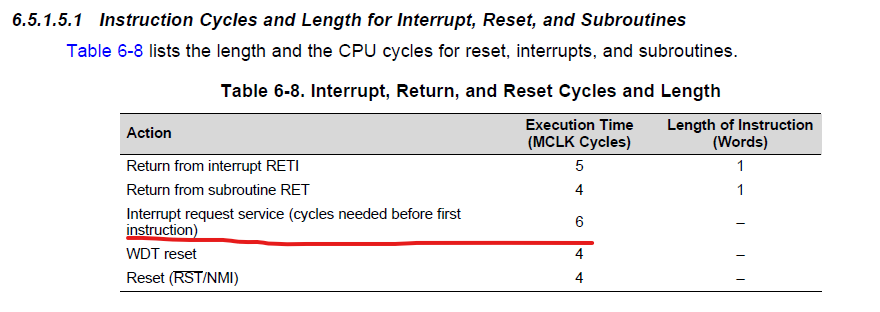

    3. Actually, it will delay for some cycles. They are combined of 2 parts. The first is to enter ISR, this you can refer to UG. The second is to execute code, this you can use CCS to view how many cycles it used.

  • I cannot combine the two pulse trains into a single TDx because:
    • The long 1-second period requires a very slow clock ( 62500Hz ) in order to generate the pulse intervals
    • The preamble high/low times are on the order of 128us, requiring a very fast clock ( 16 MHz ) to generate the intervals
    • TDx is only 16-bits.  So for a 16MHz clock, the max interval is 65536*62.5ns = 4.096ms
    Thus this application needs two clocks, as described above.
    Thank you for the suggestion to use CCR0 of TD0.  I think this can be done because the CCR0 resource is free and unused at this time.  However TD0 must run in CONTINUOUS mode for this to work, because UP mode consumes to CCR0 resource as the period-setting register.
    I will run some experiments in code now.
  • Yes, you are right.
    TDO has three CCRx, you can use CCR2. I will close this thread. If you have any new problem, you can create a new one or just reply under this thread.
