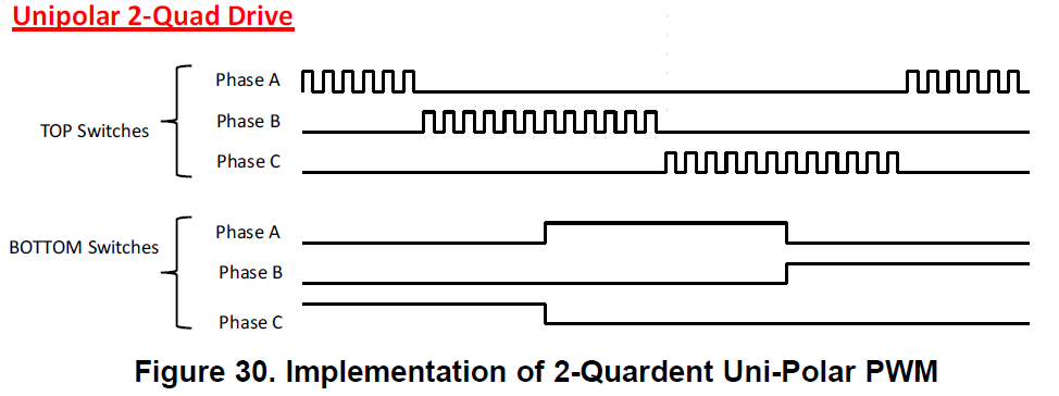

I am currently working on an application to run a simple program on my sensorless BLDC motor using DRV8313EVM module (48V, 35watt). I would like to run the motor in standalone mode with a certain set of algorithms with DRV8313.
I am not able to understand how the bottom switches pulse generates with which timer? The DRV8313EVM is used. The file attached here is from slvu815a.pdf, “ DRV8313EVM User’s Guide”.

    I'm not familiar to DRV8313 2-Quardent Uni-Polar drive mode. But according to the timer initialization code, the Timer A0 Compare channel 2 and Timer A1 Compare channel 2 to generate PWM at pin TA0.2 and TA1.2. Please see the MSP430G2x53, MSP430G2x13 Mixed Signal Microcontroller datasheet (Rev. J) and MSP430x2xx Family User's Guide (Rev. J) Timer A module for more information.

    Using timer TA1.2, 3-PWM signal generated by the ports P2.4, P2.5, P3.3, it's fine and TA0.2 is used for P3.0
    But how P3.1, P3.2 generates the active signals pulse? Not able to understand with the above timer initialization code.

    I checked the DRV8313 datasheet and the schematic of DRV8313EVM.
    It seems that the DRV8313 doesn't support separated control for high side and low side switch. The states of each leg are high, low and Hi-Z which are controlled by the INx and ENx signal.
    So I think the active signal on bottom side doesn't mean PWM pulse. It means a ON state. The 2-Quardent Uni-Polar drive mode is implemented by the PWM on INx lines and signal on ENx lines. Just like the trapezoidal commutation described in DRV8313 datasheet.

    But my question is how to generate the signal on ENx lines ? and how the MSP430G2553 Pin 3.0, 3.1, 3.2 generates the signal for ENx lines. Which timer is used
    Ajeet
    To generate high/low signal, you can use the pin as GPIO output function. Take P3.0 as example,
