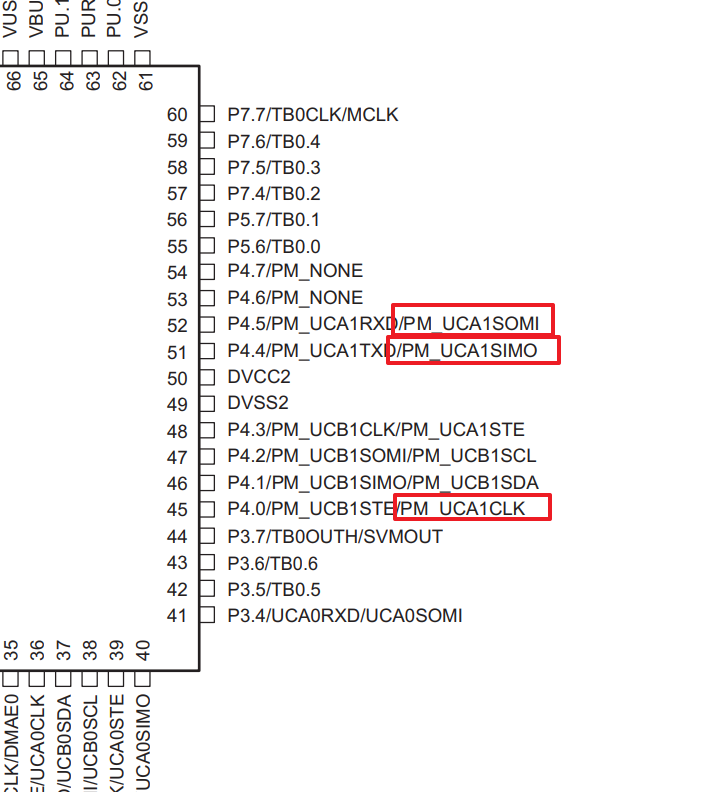

Hi experts,
I'm using Port 4 for USCI_A1 Spi configuration, but in datasheet port mapping is there for port 4 so that we can use it by configuration through port mapping.
Here's what I have tried but it doesn't update P4MAP0 and so on registers can anyone please check and let me know where I'm going wrong.

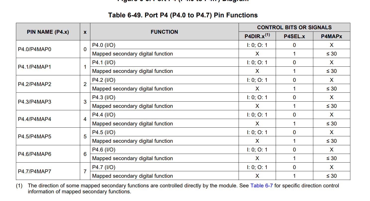

Hi Manish,
When you set the P4MAPx register, you also need to set the P4SEL and P2DIR registers to achieve the function you want.
If you would like to use the USCI_AI SPI function, as described in the Datasheet, you need to set:
P4MAP0: 0x0D P4MAP4: 0x0C P4MAP5: 0x0B P4SEL : bit0:1 bit4:1 bit5:1 P4DIR : bit0:1 bit4:1 bit5:0
Some data in datasheet as your reference :
