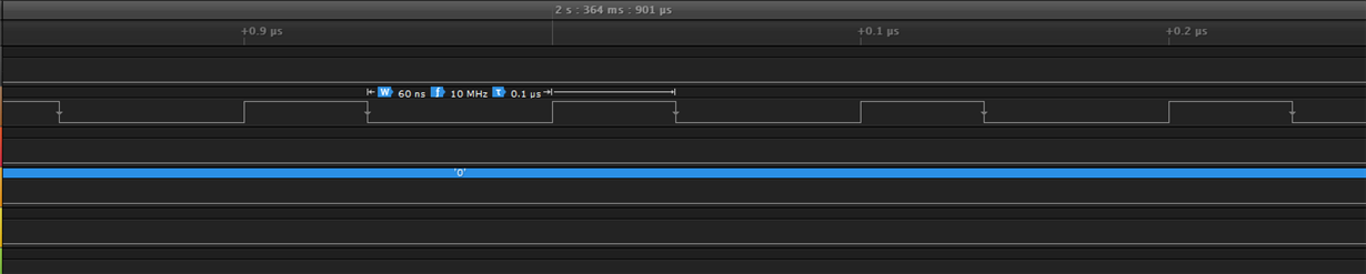

So I've been working with the MSP432E401Y's spimaster example with SDK v3.3. The external ADC I'm using needs a high SCK Frequency (ideally at 85 MHz). But, the MSP432's documented maximum rate of 60 MHz would work too (unless there's a way to go higher than that). I'm setting the bitRate to be 60 MHz, but it somehow maxed out at 10 MHz when I looked at it on a logic analyzer. How would I configure it to get a larger frequency?

Logic Analyzer Output:
