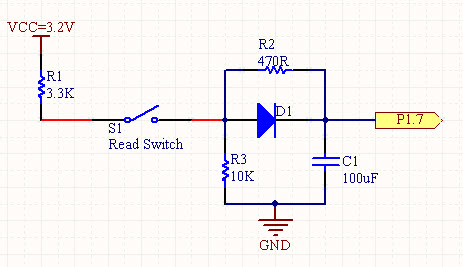

I have a problem using MSP430 interrupts.

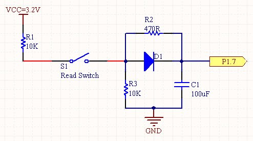

The thing I want to do is to toggle the P1.0 Pin on "MSP430F6137" on a "Low to High transition" on pin P1.7 (i have attached a read switch with a debounce circuit)
here is my circuit:
the circuit works well in normal condition but when i turn on a DC motor (3 Volt - 20mA) The LED Blinks very fast (Much faster than the Input Clock of P1.7)
The pull-down resistor (for P1.7) is Enabled. I want to Eliminate the bounce with hardware circuit to avoid unwanted interrupt.(after this step  i'm going to Use it in very low power mode)
Is it Noise that generate Interrupt ?
Is there any problem with my code?
and here is my code:

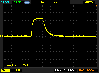

The P1.7 Pulse Image:
as you seen the Low to High Pulse is sharp but when the DC motor is ON The MCU Generate Unwanted Interrupt every where (not only in Low to High transition)

  • Your debouncer has a major design flaw:
    You load teh capacitor through a 10k resistor. Yet the capacitor has another 10k in parallel to ground. This means that the maximum voltage you can load the capacitor to is 1.6V. This is in the area of the input pin hysteresis. Through the diode, the loading voltage is even reduced to (in case of a schottky) 1.4V and then the additional 470R are in row with 10k pullup filling it up to 1.56V.
    Taking 3.2V as the MSPs supply voltage, the schmitt-trigger inputs require 1.5V..2.1V as positive going voltage. The negative going voltage is in teh range of 0.75..1.65 with a guaranteed hysteresis of 0.4V. So any signal causing emall changes in the voltage will cause the inputs to trigger. If you're unlucky, your DC motor (or any other periodic distortion) may even cause the circuit to oscillate around the trigger point.
    If you lower the pullup resistor to 4.7k, you shift the whole thing up by 0.5V. Which then is in the worst-case range of the positive-going threshold and well above the negative-going threshold. 3.3k would be even better for the pullup.

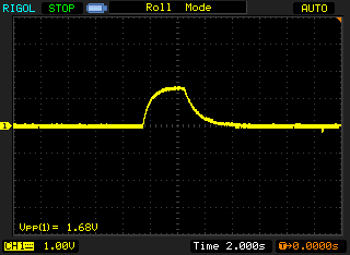

  • Dear Jens-Michael Gross
    Thank U for Quick and Useful reply.
    I have changed the Debounce circuit as you said :
    I have replaced the 10K Resistor with a 3.3K one and here is the Screen shot of my pulse:
    as you see in above picture the Vp-p = 2.63

  • Well, the signal looks much better now. :)
    Another thing I'd do: you used a 100µF capacitor. This gives you a signal rise time of half a second. This is an eternity. I'm not sure what happens on the MSP port for such a long slow rise. Normally, I'd think that after the rising edge has been detected, no more interrupts will come until a falling edge is detected. so your code should be correct. But when the 'trigger point' is reached/crossed so exteremely slow, it might be that the circuit will keep the IFG bit set.
    Personally, I never used a capacitor larger than a few 100 nF for debouncing.
    Manually clearing the IFG shouldn't be necesssary, as it is automatically cleared by reading the P1IV register. But in this case it seems to resist even manually clearing....
    What you can try is to 'disarm' the interrupt by switching it to detect the falling edge. (and when an interrupt comes detectign the fallign edge, siwtch it back to rising edge and do nothing). and then manually clear the IFG bit.
    As an alternative, you can drop the debouncing circuit completely and introduce a software debouncing delay: once you got the first rising edge interrupt, disable the port interrupt and start a timer delay. When the timer delay expires, check whether the port pin is still high (to ensure that it wasn't just s apike) and re-enable the port interrupt.
    There are several variants of this possible. With such a 'software debouncer', I was able to eliminate the need of a debouncing circuit completely, saving some bucks on the hardware.
    You should, however, check your VCC during noise. And with a much higher resolution than the above 2s/div. Maybe it's not the input signal itself that causes the trouble.
