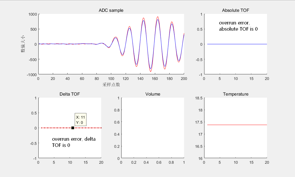

When I use EVM430-FR6043 to do test on my runner equipped with ultrasonic sensors, somehow GUI UDC notices me "correlation overrun error".
Sometimes the measurement carry on correctly,  sometimes not.
Could you explain some limits of "correlation method" in the demo "UltrasonicGasFR6043_02_20_00_12_windows_installer", so I can configure parameters that would avoid this kind of error.

    It might related to the amplitude of the ADC signal. Could you share some ADC captures and the configurations you are using here?

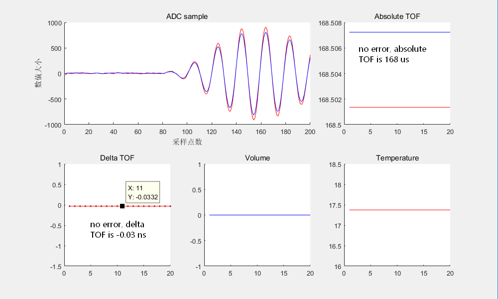

  • Hello
    The error comes about very often. I save the normal and error measurement ADC samples of consecutive measurement, and used saved ADC samples to run algorithms.
    I'm using my own GUI on Matlab. The following are two screenshots.
    The samples are nearly the same.
    The results of these two samples remain unchanged.
    Some parameters:
    1. ADC max count is about 900
    2. ADC start time: 140 us
    3. capture duration: 50 us
    4. Over sampling rate: 20, sampling frequency: 4M
    5. Single tone: 200kHz
    6. USS_GAIN_RANGE: USS_Capture_Gain_Range_1_0
    For more parameters please let me know.

  • Hi Guangyu,
    I would suggest you to change your sampling frequency to 1MHz and the capture duration to around 200us where ADC capture can get the whole signal.
